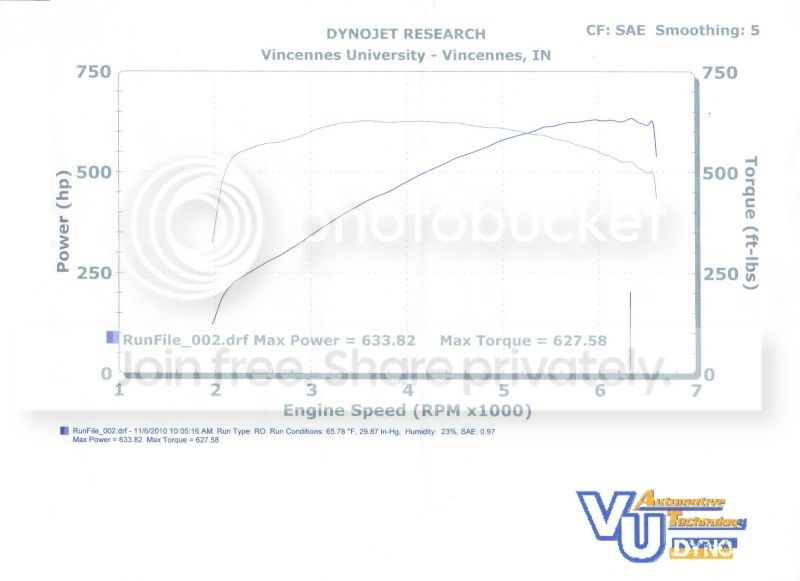

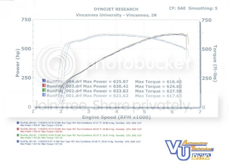

VU had a dyno day yesterday. It was time to trial to dial in my E85. Unfortunately my i was only able to load two tunes.
18 degree and 20 degree. Diregard what the videos say. I thought I was loading tunes for 21-23 but my tuner forgot to change one of the spark tables which limited me to 20 degrees.
Run 1 = 18 dgrees
Run 2-4 = 20 degree
Run 1 = 18 dgrees
Run 2-4 = 20 degree

i went to VU for a year and didnt have a clue they had a dyno thats sad on my part. nice number though man and great looking car
