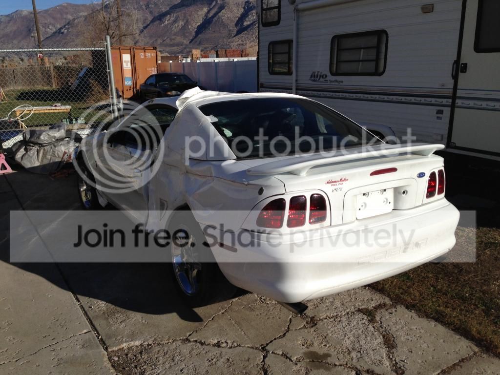

Here is what I started with
i traded this 99 Yamaha R1
For this 97 Cobra it came with most all parts to put back together but only a gt block that needed fixed, Also came with a tubular k-member full turbo kit with manifolds minus the turbo, nitrous kit, long tubes, aluminum driveline. all the parts filled the back of my long bed truck. The bike was worth about $2000 so i think i came out pretty good

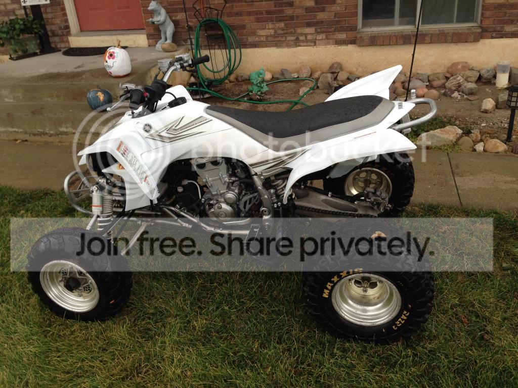

I picked up another short block from a GT to get the car running but after a while i decided i didnt want to run a GT block so i sold my YFZ450
and picked up this for $2200 runs and drives

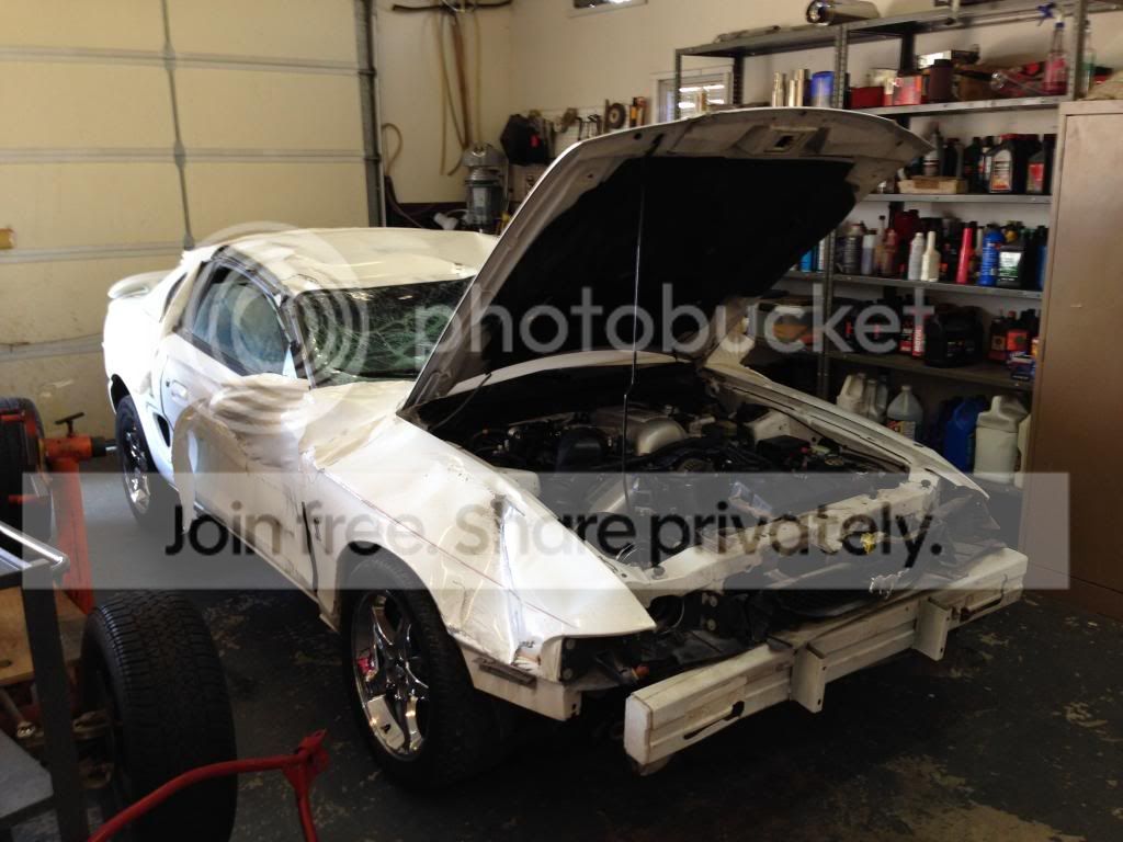

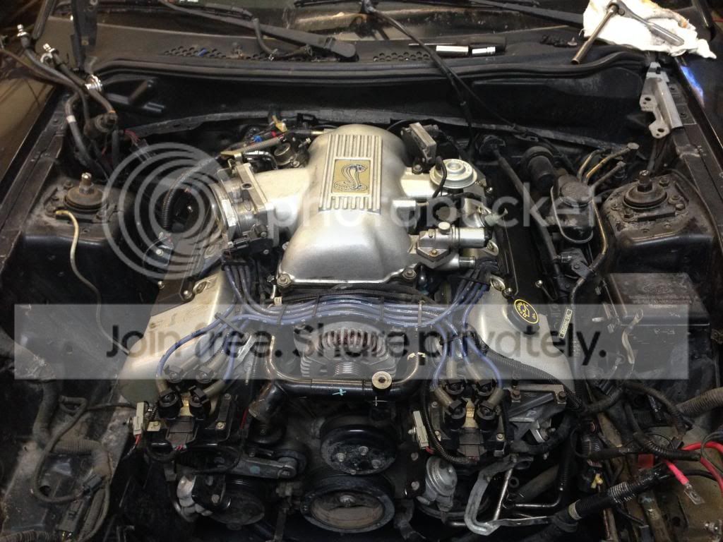

getting ready to pull the motor
and its out
and going in
set in its new home
a little more done
got some wiring hooked up and almost nothing worked so i looked at the fuse box under the dash to find that the previous owner pulled every fuse out, got them installed and everything seemed to be working. just have the exhaust, radiator and a few things left before the first start up in this car

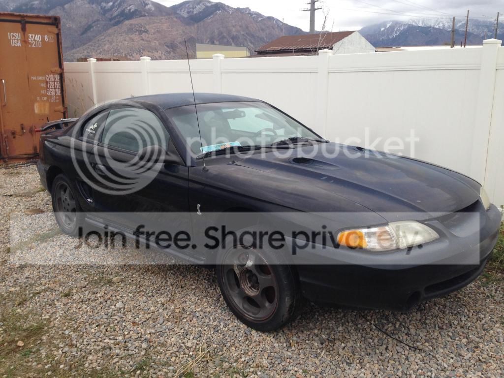

oh i ate lots of food. got it ready to start today and it ran for a sec then died, found out the theft system is shutting the car down. not sure what the previous owner did.

i tried switching the theft box in the trunk and the ignition switch and key from the white car, still didn't work. i seen i might need to take the computer from the white car also for the pats to work. is this true? will i need anything else or just the box in the trunk the computer and ignition switch and key?

yep the pats is the only thing stopping me. i wish i knew what the previous owner did for it to not work. but the white car started and ran so i think as long as i transfer all the parts needed for the pats it should work

got it figured out, on 96-97 you can program your own master key but it takes 45 min to do. so the car is running but has an exhaust leak, and need to finish up the interior, front brakes and wheels and tires
