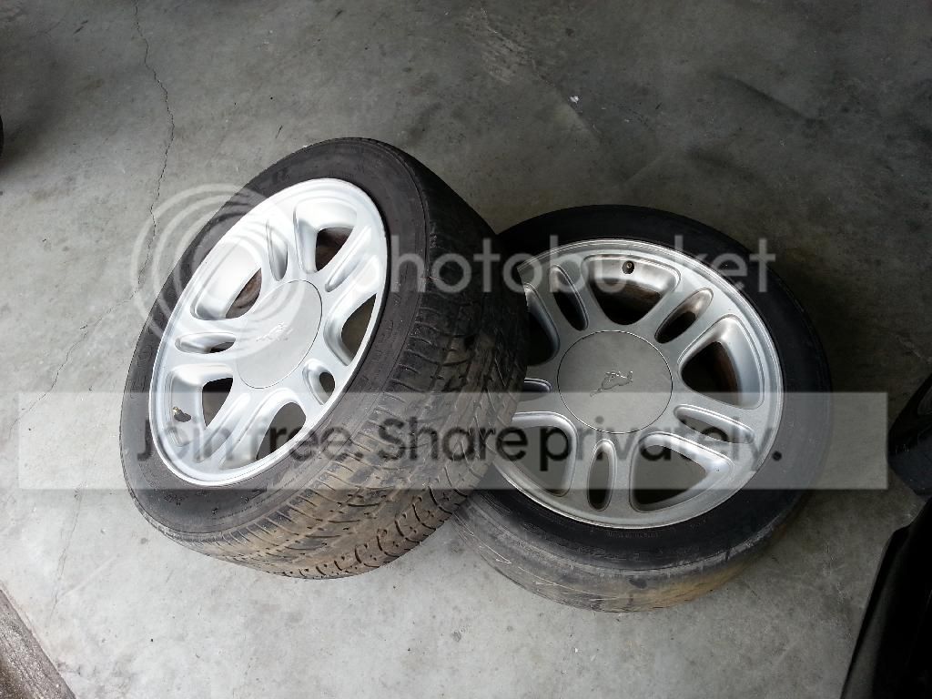

Was at the junkyard yesterday.
Picked up some new vac lines and an IAC off a '96 GT. Yanked these from it too, possible future drag wheels.

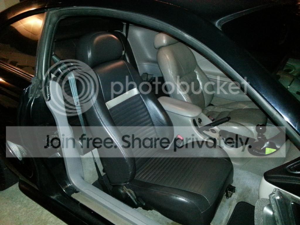

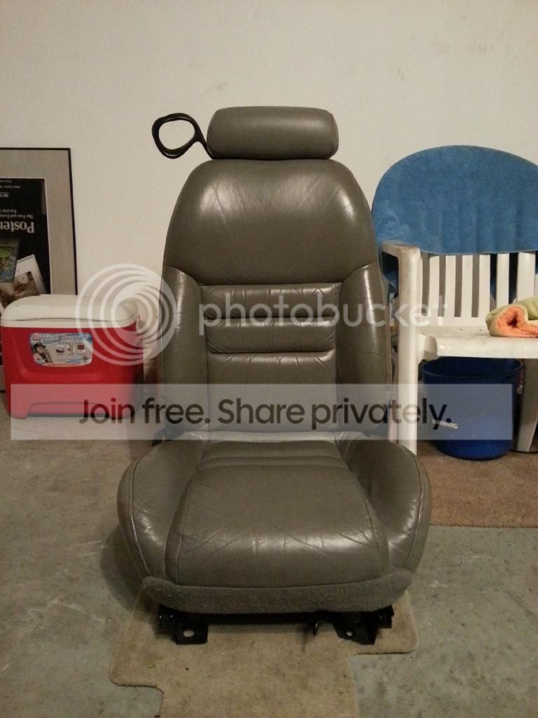

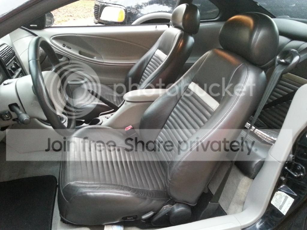

I bought the whole set from Joe.
So i wasn't, and couldn't empty my checking account in one fell swoop. I decided to give him a down payment in exchange for the backseat, and then pay for each front seat individually.
My apologies for taking a week or two to get ALL of them installed.

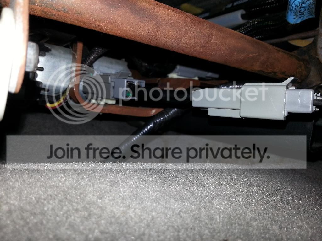

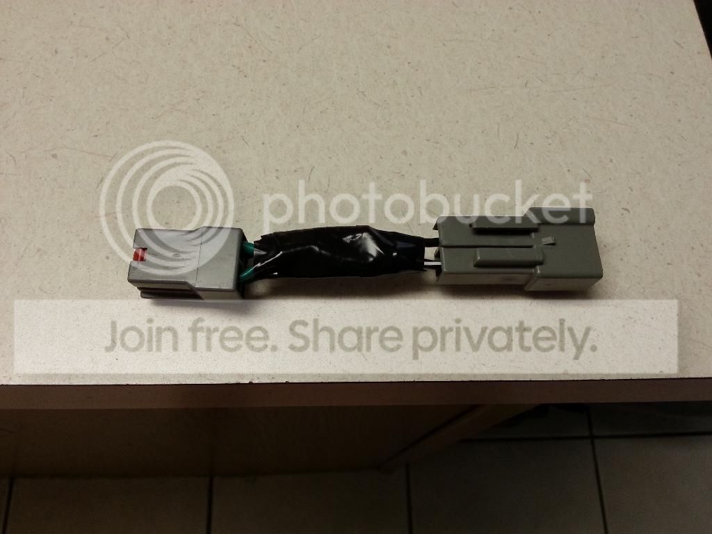

This is the adapter harness that was made to exclude the cutting of either seat, or body harness. So if i were to ever sell the Mach1 seats i could easily throw some '94-'98 seats back in it.
Male '99-'04 plug, with female '94-'98 plug.
The wire left out is the seatbelt wire, not needed for '94-'98s.
Some electrical tape for peace of mind.
Hooked up.
And voila, 8way power adjustable seat.
