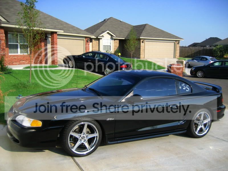

Well I have been a long time creeper so I figured it's time to post up. This is my 1998 GT. Bought it back in march as a quarter life crisis car. Got it from the original owner with only 82,000 on the clock for 6k. As stock as it was the day it was new.
Since then, I added:
-Steeda sub frame connectors with torque box plates
-H&R supper sports (1/2 coil cut in front to compensate for thick isolators)
-Tokiko shocks/struts
-Urethane isolators
-MM cast camber plates
-Steeda Bump steer kit
-MM rear adjustable lower control arms (no wheel hop at all now!)
-Summit Racing off road H with weld in magnaflows
-FRPP 4.10 gears with new yukon posi carrier
-PI cams/PI intake manifold
-A/C recharged! :p
-American Muscle 18x9/18x10 Saleen reps
-New black carpet (dynamat'd the car when interior was out)
-Double Din radio besel swap With Jensen touch screen Nav
-Bama Tuning with SCT tuner
-Rear seat delete
-Track weight of 3,275lbs no driver 1/2 tank gas 3,430lbs with driver 1/2 tank

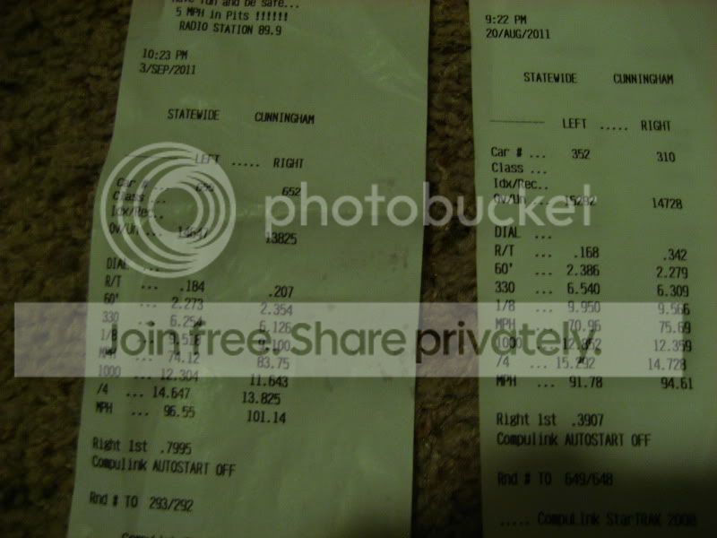

I am in the LEFT lane in both time slips. The slip on the right, slower time slip, is WITHOUT PI intake/PI Cams. They made a pretty damn big difference! Next mod is going to be some ET streets so I can get that 60ft down! Both nites temp was over 90 degrees at 1291 ft field elev.
So I have been busy on this car for the last 6 months. All work was done by myself except the sub frames and muffler welding. I had 3 mustangs growing up and this is number 4. SOOO happy to be behind the wheel of one after 8 years! Hop you guys like it!

Thanks guys... It's been a fun car so far! Never knew these modular motors were so easy to work on! Always was a 5.0 guy until now.

Fuck me that's gorgeous...you really can't beat the stock look. I got a black '98 myself...doesn't sit like yours though...4x4 for mine atm.

Great pickup and looks like your having a lot of fun with hier. I think you've done more in 6 months than I have in over 6 years. Congrats on the excellent runs and I love my car soooo much better with the PI cams and intake and def made a huge difference not only in SOTP, but on the track as well as you shown. Enjoy!

Thanks everyone! Its hard to find a mustang that hasn't been molested to all hell. I took me almost 5 months to find this one. Bought new headlights, clay bar'd it, and waxed it and it looked almost like the day it was new. Already have the itch for some bigger cams... I really wnt to get into the 13's before winter.
