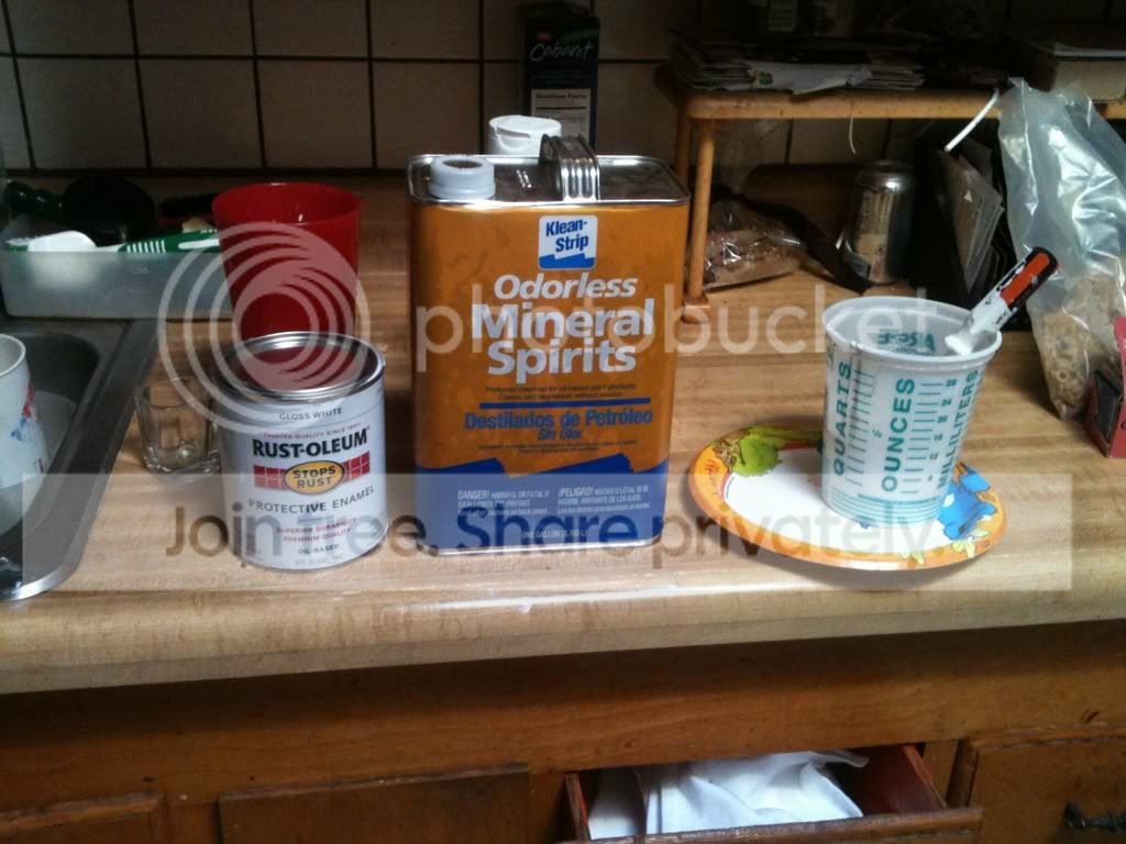

for those of u asking here is the paint i am using

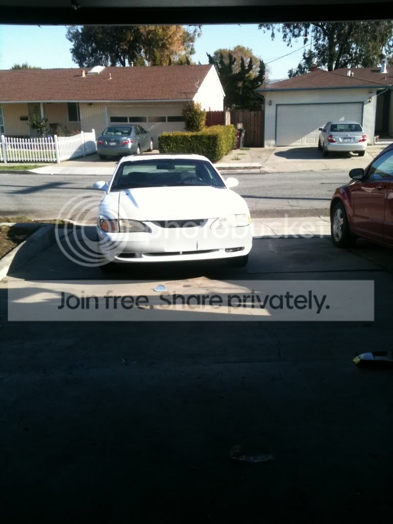

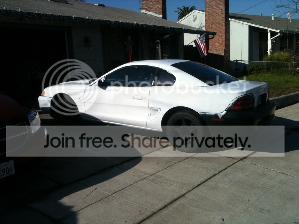

here is coat 5

I hope you wetsanded between 3-4 with 800 grit. Its looking pretty good, I would suggest about 8 coats, but you can always do more later if you decide to stop thats the dope thing about this paint.

i never heard of this whole proccess but i would like to know all the little details maybe im being a lil astonised but are u rolling the paint on with a paint rollor im dumbfounded to the point i feel retarded. teach me all mighty one :notworthy:

yes its a roller with a high density foam roller..mix the paint and mineral spirits 50/50 and stir not shake it to mix it then apply
