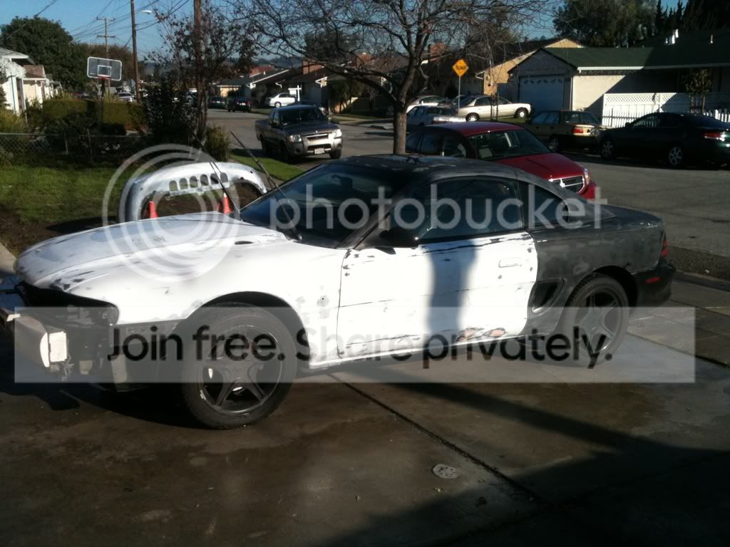

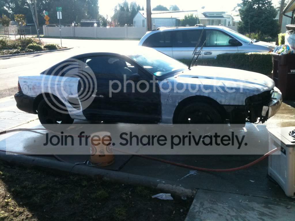

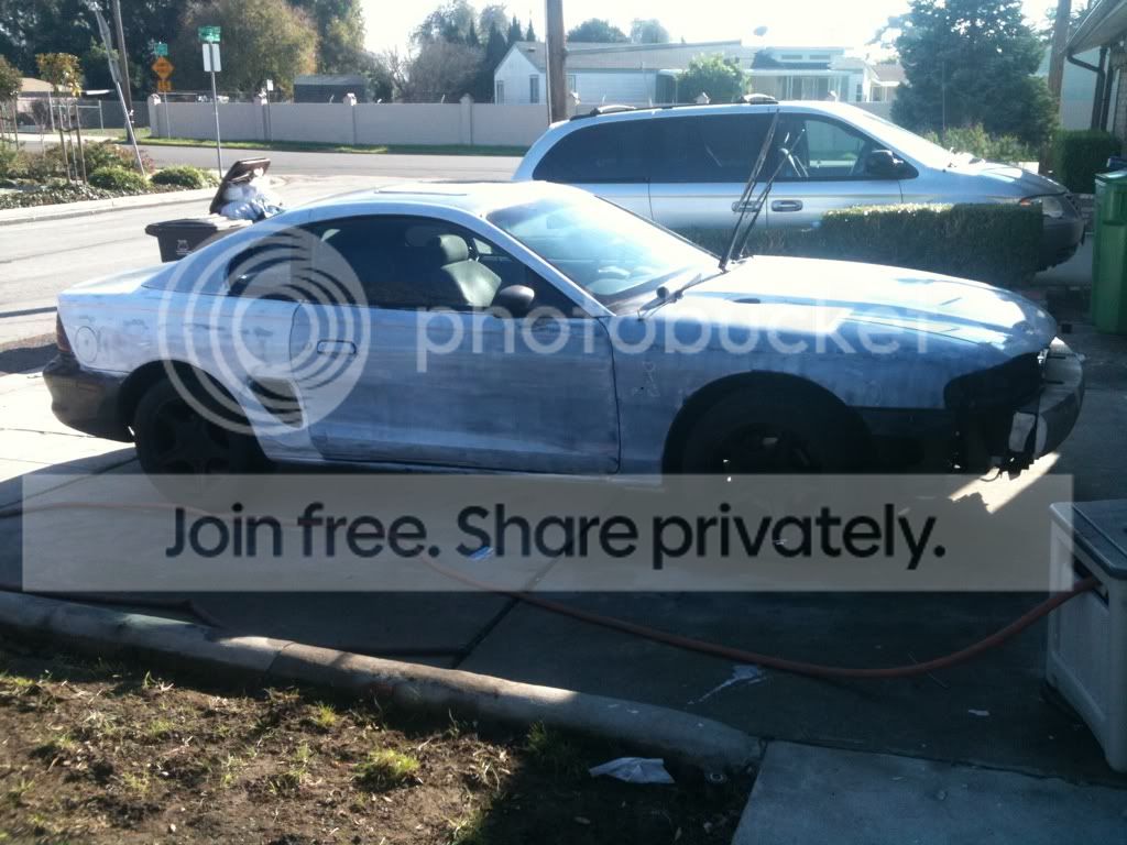

ok since i dont have a butt load of money to drop on a nice paint job id figure id do the roller paint..since i have a couple of personal friends that have done it and 1 of them is on this site(Brad) and his turned out pretty good so here are some pics and the steps i have taken so far..

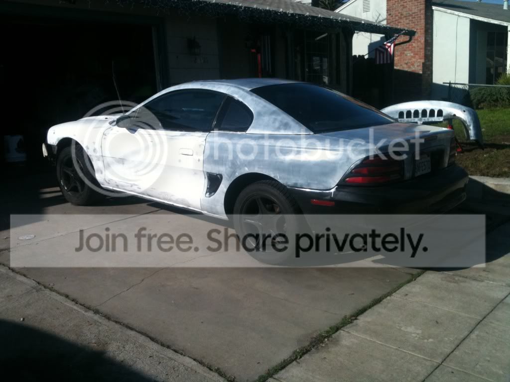

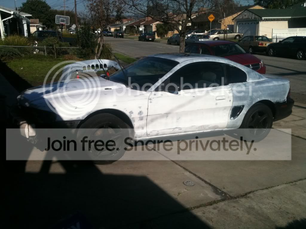

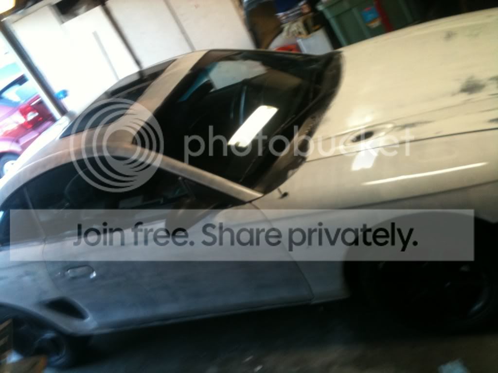

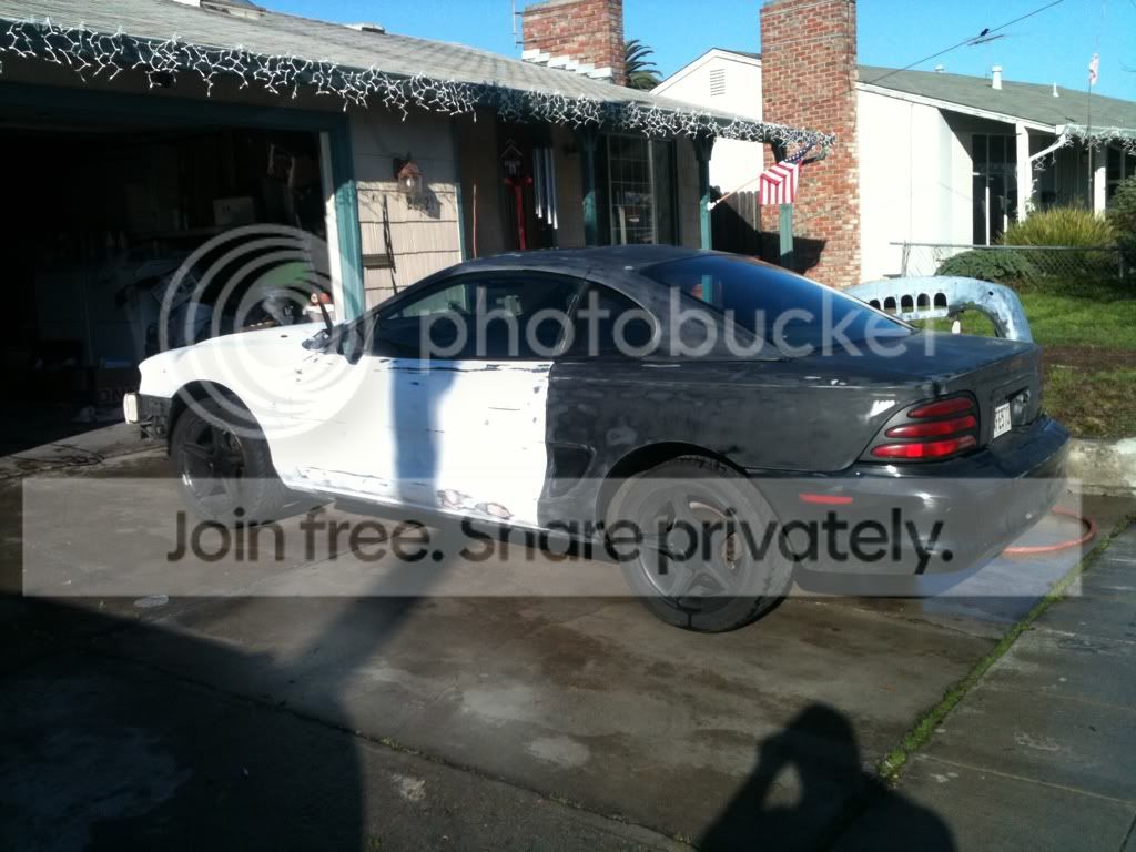

1/4/2011.a couple friends and i spent all day yesterday and this morning doing the body work and gettin it all sanded down,and replacing the front nd rear bumpers,nd the header panel.here it is all sanded down and washed nd dried off..

mosdef..im going to have the first coat done today,then 2nd coat 2morro which will b follwed by a 600 grit wetsand which will then be followed by coats 3,nd 4 followed by 800 grit wetsand then coat 5,nd 6 followed by 1000 grit wetsand and the same after coat 7 nd 8 shud take me about a week

Good luck bro. Oh yeah and dont forget to take down your christmas lights...

Lookin good Peter. Make sure u sand it by hand tomorrow with 600 grit, thats gonna take off a good bit of paint from your first 2 coats , but its gonna lay down the orange peel, so your 3-4 coats will go on just as smooth. Make sure you sand it WELL it usually takes me about an hour to sand everything if I dont take a break. make sure the paper is wet.
