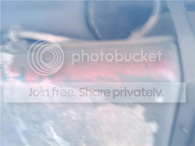

Car window wont roll up all the way?? I've already changed the lil cap bushing things inside the window motor, i have'nt replace the window motor but it works until that one spot, when it gets to the most it can go up it starts making a popping noise, kinda like a machine gun lol, and when i roll it down all the way it makes the same noise
just wondering if this "DENT" can be fixed or would i have to get another rear fender?? and if it can b fixed what would be the best way??
This i notcied the other day, im guessing it fuel, but not sure y its doing that :S

on the window it could be the window regulator or the motor itself?
the dent could be fixed.
on the gas tank does it smell like gas, if so check the grommet is the seal around the filling neck.

Javi nailed it.
Replace the window motor, get a new filler neck grommet, and learn to use bondo.
You will be set :)
