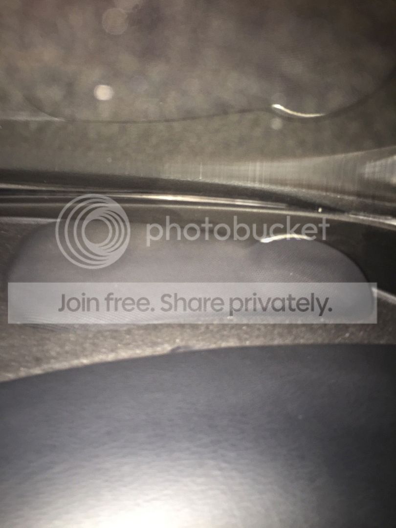

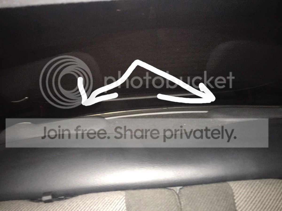

[/URL] [/IMG]
So in the first picture the one on the bottom side of door rattles a lot and cant handle much bass at all im talking very little. the back seem fine. The speakers are pretty clear and all around sound good except for the bass is super super low
i took with phone with flash on thats why it looks weird

If your speakers rattle, they are either loose (like a screw or two is missing) or actually blown. They can still sound decent at higher frequencies because they might have tweeters and/or the higher frequencies do not move the cones nearly as much as lower frequencies (bass) does. My guess is your speakers are probably shot. Are they original?
