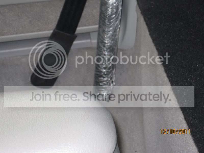

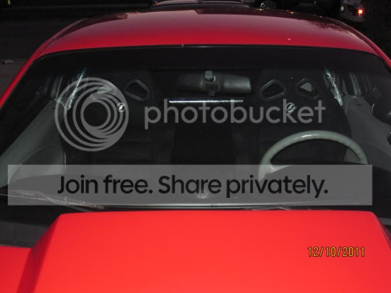

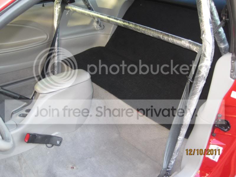

Finally finished up installing my 4 point MM roll bar, powder coated matte black (i still have the wrap on for now) and also installed my new Corbeau microsuade TRS seats. Took some time to do the roll bar, but my dad and I took our time with it and I couldnt be happier with the end results. Enjoy:

Looks awesome bro. Did you bolt the bar in or weld it? Seats look killer also. I've got the same interior and am still debating on what color seats I want in mine..Great job!!

98rocket - thanks for the compliment! Bolted and welded, was a lengthy process but well worth it. As you can see I went for a gray/black theme

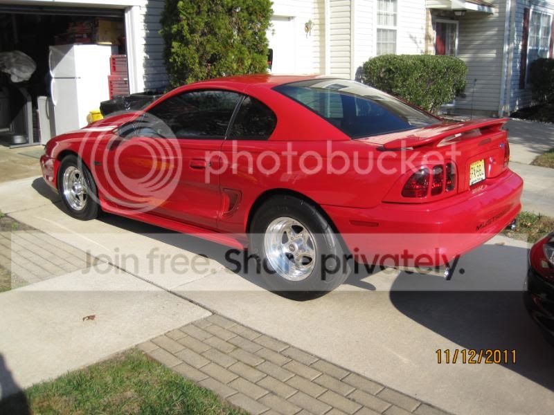

thanks a lot, appreciate it! Wheels are Weld Pro stars, 15x4 up front and 15x9 rear. Kumho front runners and rear is a 275/60/15 which is a 28" tire. I am going to be rolling my fender lip this winter and will probably go with the 295/55/15 Mickey once these wear out

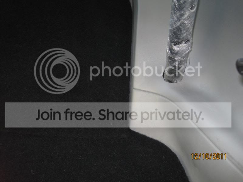

Car looks awesome and very clean install! How did you get the bar in there without cutting the interior 1/4 panels though?

thanks a lot guys. I just never liked the look where you see the huge cut through the interior panels, so we installed the roll bar for measurement purposes, took it out, cut it off from the plates at the bottom past the point of the inner panels, had powder coated, reinstalled and slid the interior panels on the bars, than had re-welded to the plates and simply slid the inner panels down into place (hope that made sense). Definitely more work but I think completely worth it in the end
