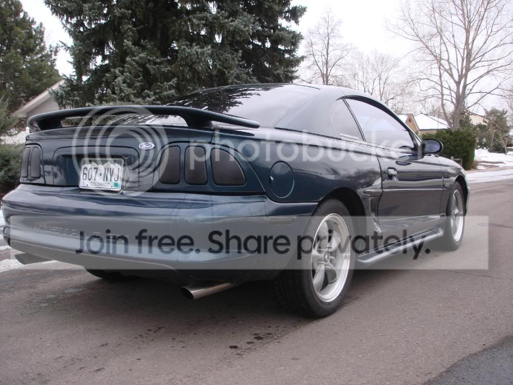

3" Wheel Studs dont look as bad now!
I really like the way the bullitt wheels look on the car!
Next visual mod will be an S281 Saleen Wing, and a 3in cowl hood!

I love the Bullitts [more so as i have them] they suit your car, whats with the James Bond style tyre shredders? :snow_laugh:

I like them a lot better than the stockers! Especially with those studs.

well i have to have the studs if I want to run teh Prostars at the track. Otherwise I would have stockers on there! 1.25 inch spacer on its way to help out on the studs!

I had the same similar issue with the studs, what I did was buy a set of studded 1 inch spacers off ebay, then I knocked the studs out and slide them over my 3 inch wheels studs. I then had the normal amount of threads when I was running stock wheels.

It looks very nice!! Why is your studs like that? Is there a real reason I don't know about?
he has 3 inch studs to run drag wheels.

1 inch or 1.25 inch? Do you think it will matter Dave?
well with the 1 inch you will be able to knock out the studs in the spacer and just slide it on. You are running 8 inch bullets, and they wont be completely flush with the fenders. With the 1.5 you could leave the studs in the spacers and bolt them up...either way, you will be fine ;)

thanks, I think I'm going to try, 1.25 spacers and knock out the studs and do it as a disk.
Thanks for the complelements guys.

Looks alot better.. I think the color of the wheels match your car perfectly.. But i also have 1in studded spacer to run my draglites and i run my stock sized studs.. But IMO i would get 10.5s DD out back with a spacer.. But its look good!
