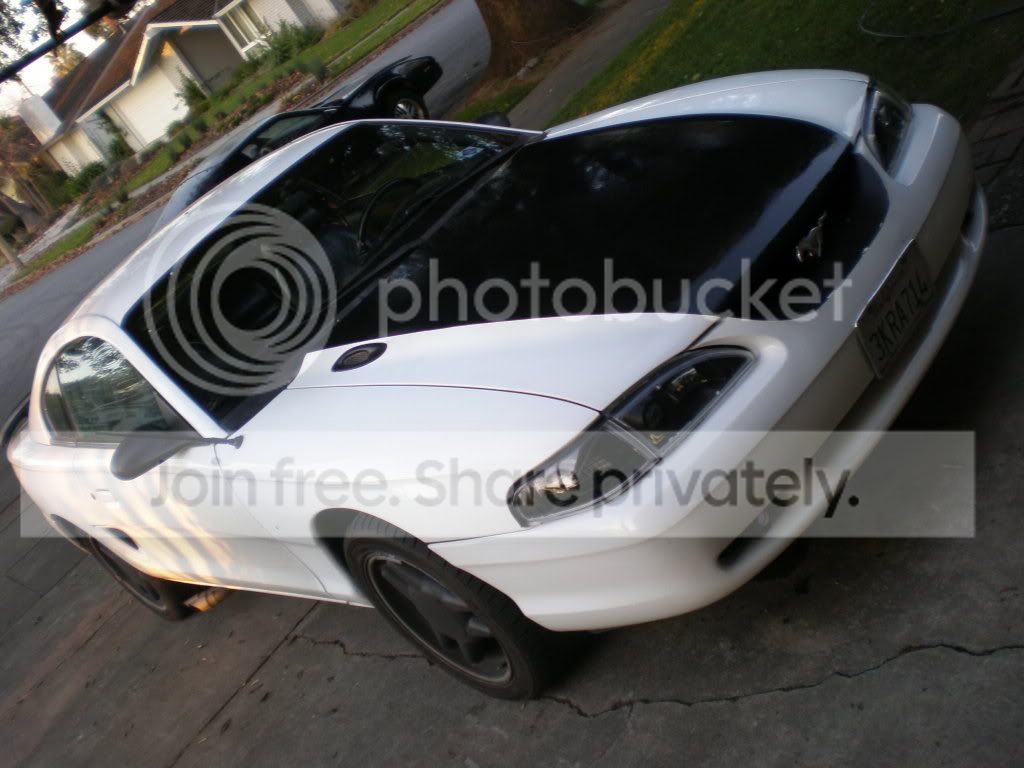

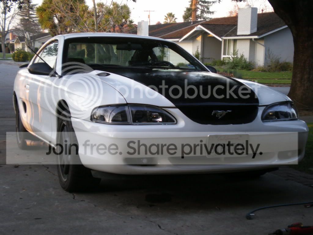

for those asking for daytime shots

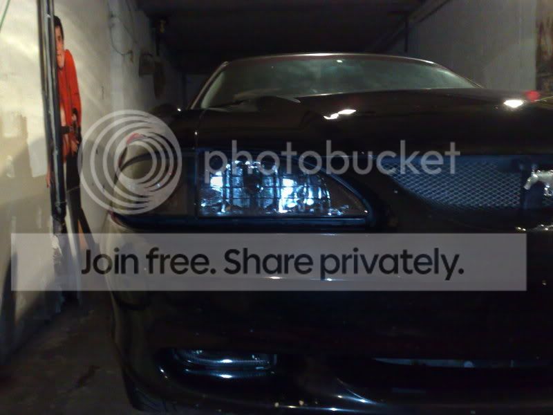

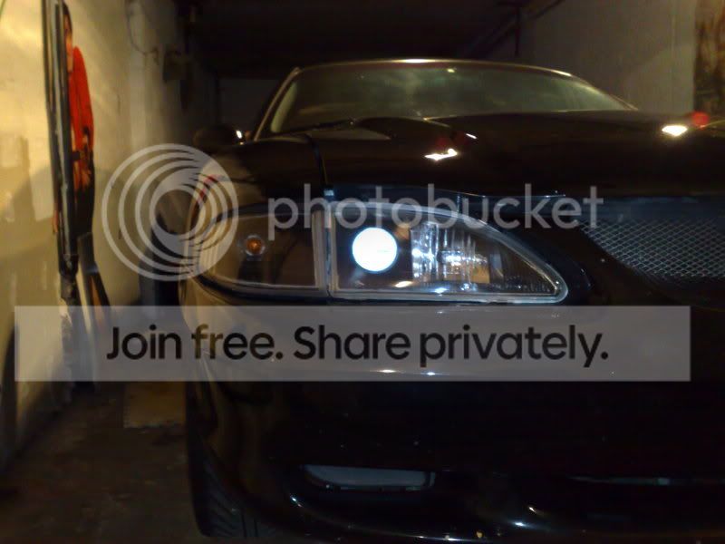

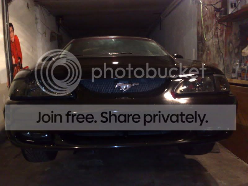

I've had both styles, the projector type and blue ovals smoked lens. I perfer the blue oval smoked for light and looks..but mainly light. When I had my projectors I found there wasn't enough light..and i had to cut the header panel to fit the projectors for the high beam bulb and for my H.I.D's(9007). Which in the end my 9007 H.I.D's would not fit cause they were to long(straight design), so I got my hand on 2 denso ballast/ignitors and fitted D2S bulbs(I'm a LandRover tech, aka where i got them), worked perfect!! I then cut up a headlight harness from a cavalier that i got from the junker to fit the projector headlights 9005/9006(My projectors didn't come with a retro fit harness..a.k.a Ebay!!)
After a years worth of driving I bought Blue Ovals Clear Smoked Lens and fitted back my 9007 H.I.D's with 8000k..Awesome!! I aligned them perfect and they don't shine into oncoming traffic like most H.I.D kits..ne-waz that's just imo
Here's some pics of the Projector Type and the Blue Oval Smoked..
