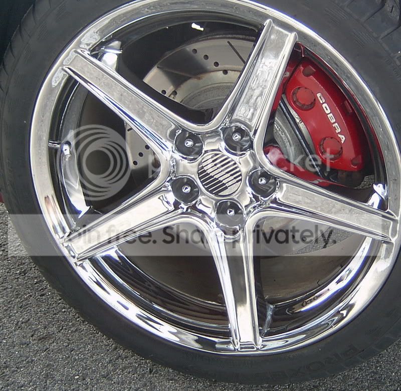

KWClutch said:
Yes that's normal but you have them facing the wrong way. [/img]
that pic is the drivers side front. they ARE facing the correct way.. if i switched sides they would just LOOK like they are on backwards.
i put them on according to the installation guide, and common sense

thanks good info but
"Bottom line - don't use the slots to decide which side to mount the rotor. Pay attention to the internal cooling vanes. For slotted rotors with straight internal cooling vanes, the direction of the slots is totally up to you and what you think looks best. In this case, there is no wrong answer."

Yeah but more than likely you'll get comments on "hey that's the wrong way". lol I know this from experience. hah

in my perspective if i saw them on the opposite way i have mine id think they are on the wrong way.hah

To address a few issues in this thread.
1. You want the vanes to be venting out of the rotor, not pulling the air into the hub. If you are pulling the air into the hub, you are keeping all the heat in there, and not cooling your brakes properly.
2. The sweep area of the Cobra caliper is what it's supposed to look like on the pictures. The caliper that's commonly used on Cobras was originally designed for use on a 12 inch rotor. As it was moved onto a 13 inch rotor for more torque, the sweep did not increase. If you want to see the rotor being used completely, check out what Brembo kit looks like. I am converting from Cobra to Brembo this week, because I want to drive past the capabilities of Cobra calipers.
