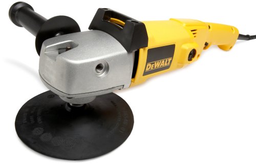

Well guys, I don't need to polish my car, but however my girlfriends 03 Maxima has a lot of light scratches and swirl marks along with some oxidation. She keeps saying she needs to get her car re-painted but I tell her all the time that it can be corrected. I want to prove to her it can. But here is where I need your help.
I already have a high speed sander/polisher with 10 different speeds. Like this one,
But this leads me to my next question. What do I need to finish the job correctly. I was going to buy these

i wouldnt use a high speed buffer to polish either....
the best polish ive ever bought out of a store is the ultimate compound which is good for taking out light and medium scratches and swirls. youd be best off going to obsessive detail and geting the megs 205/205 combo which comes with the porter cable 7424, 4 (good) polishing pads, and megs 105 heavy cut polish and 205 which is your light finishing polish. worked very well for me today i just finished detailing the mach and its flawless.

So that buffer wont do the job?
I was thinking about hitting it with a orange pad with Menzerna power finish, then the blue pad with menzerna super finish, then the black pad with the Meguiars gold class wax.

well from what i know (which still isnt close to everything) is that a high speed buffer is a little too harsh for polishing. thats why its called a buffer.
i think youd get better results with the orbital polisher and the combo i was talking about.
