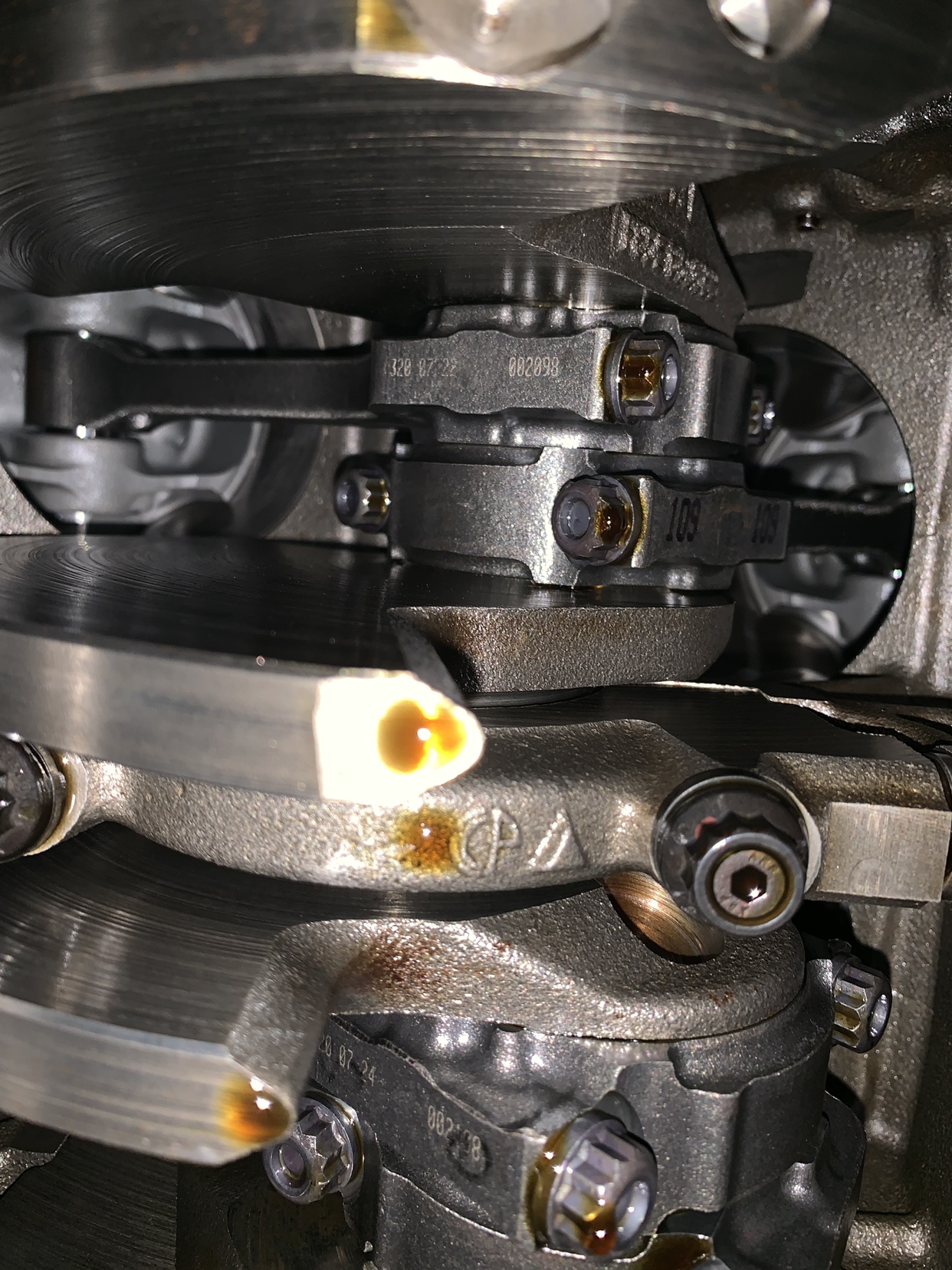

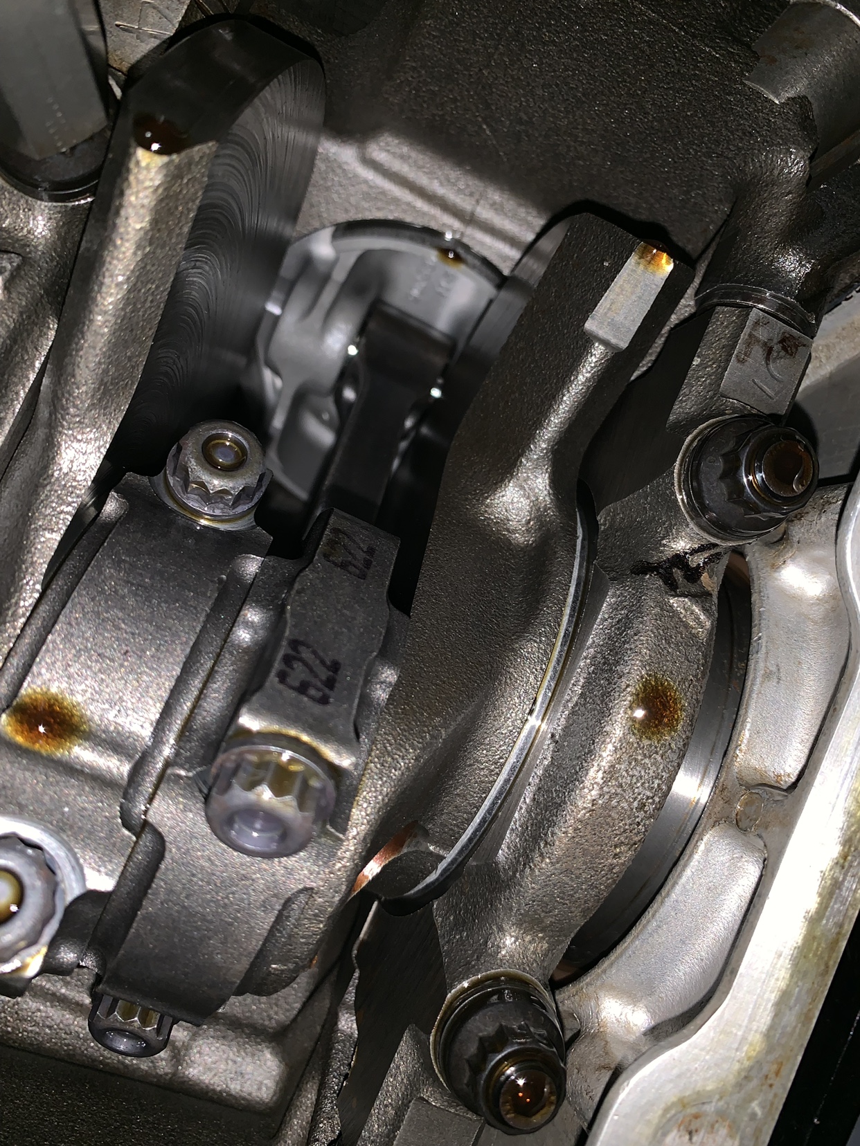

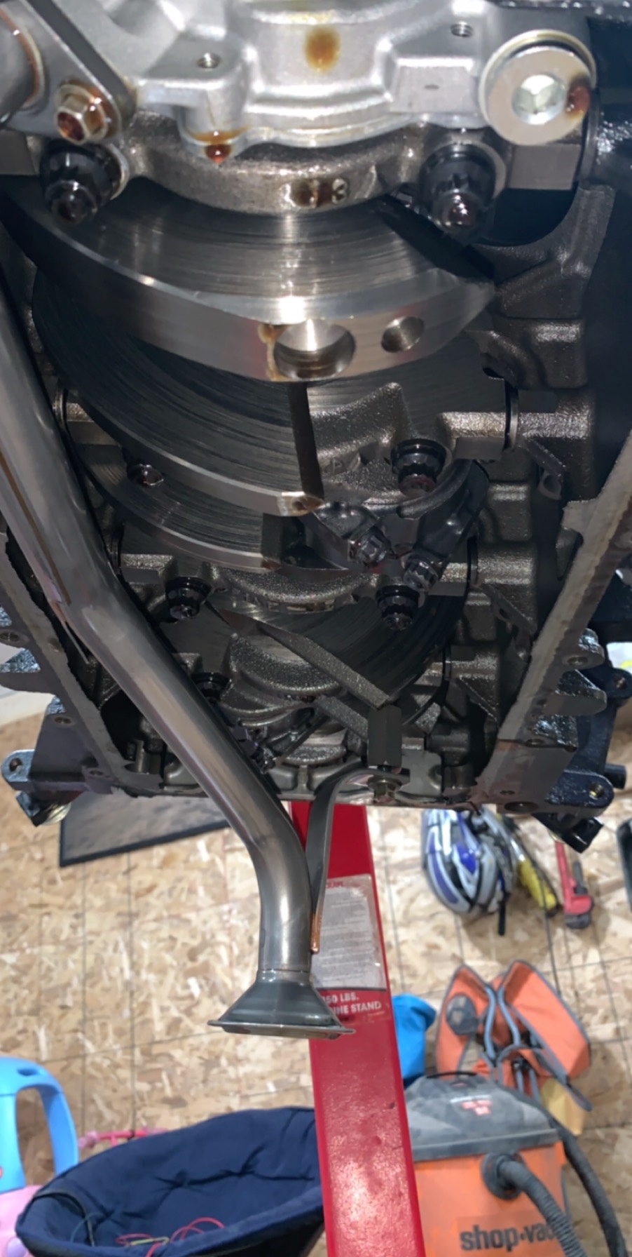

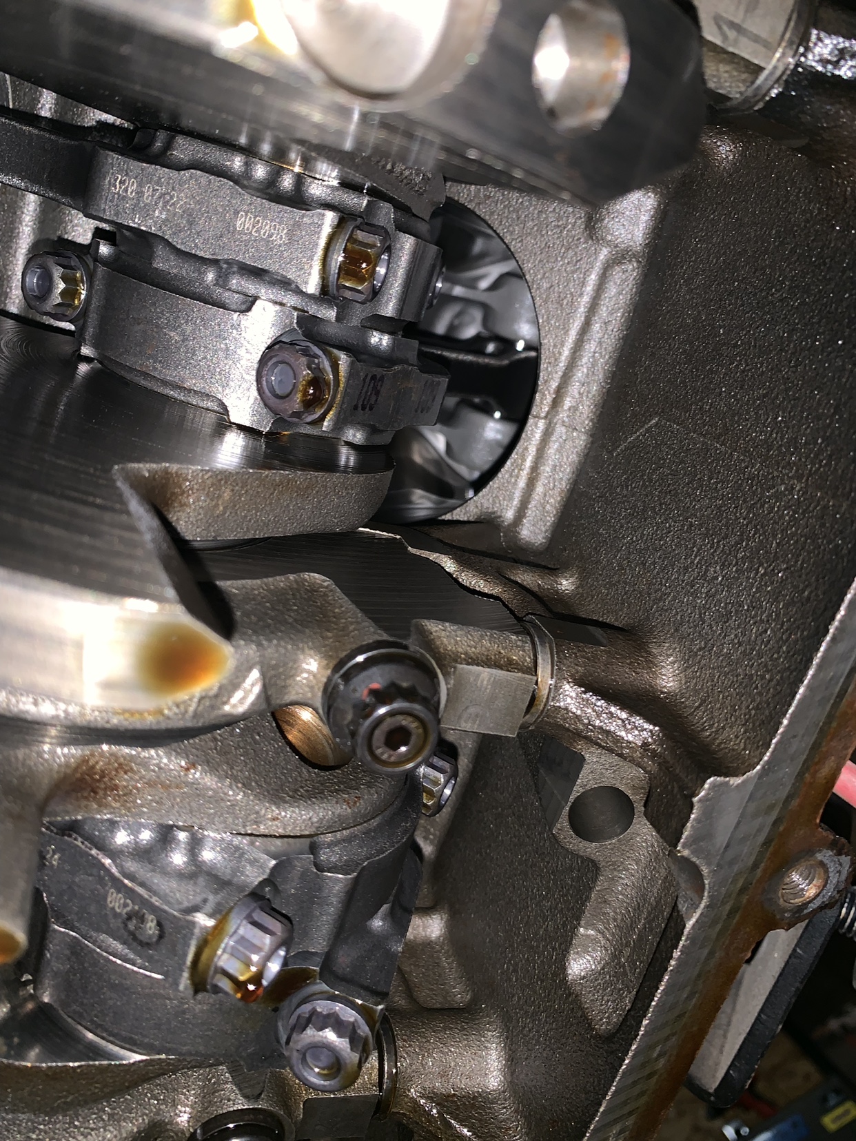

Inspected the motor today. Everything looks great no metal shavings in the pan or oil pickup screen. Internals still look new.
98snakehorse
98snakehorse
Oct 24, 2011
1,760
253
Southeast, IA
Looks good. You going to pull the main/rod caps and look at the bearings? How do the cylinder walls look?
I prob should check check the bearings. The cylinder walls still look perfect and I can still see the cross hatches.
Remind me....maybe you statedbit earlier, but what pistons are those?
They are the Mahle forged power pack pistons -16 dish.
