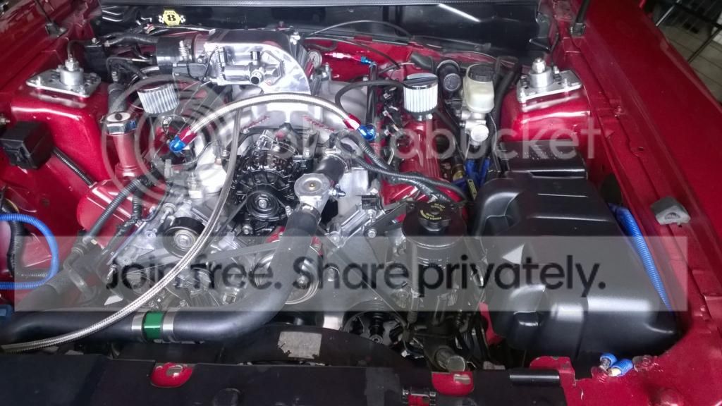

That should work fine. I ditched my expansion tank as well. Threw out the “t” lower hose and just run a straight hose to lower radiator. I have a filler neck built into my radiator similar to 94-95’s, and than just run a line to a vented overflow

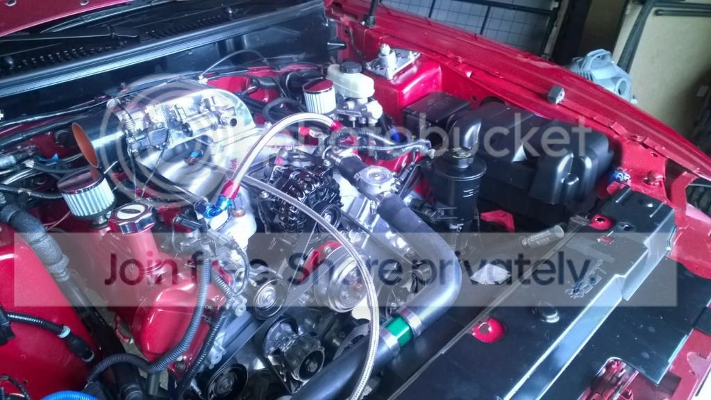

I've been looking into doing this a lot as well. I basically want to do the same thing as Mike but instead of a fancy radiator, just run an SVE aluminum 94-95 so it has the filler neck. Check out this thread

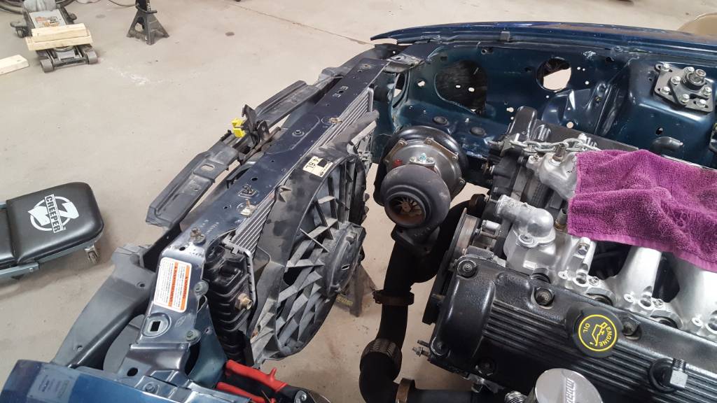

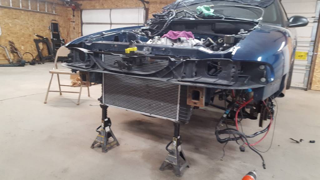

Thats exactly what I will be doing. I dont have a condenser anymore so I have plenty of room up front. The lower core support Im chopping off and welding in a tubular bar and making my own rad mounts where I can put the stock rad and fan flush to the underside of the factory top core support.

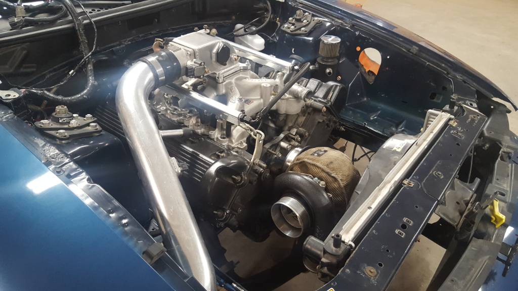

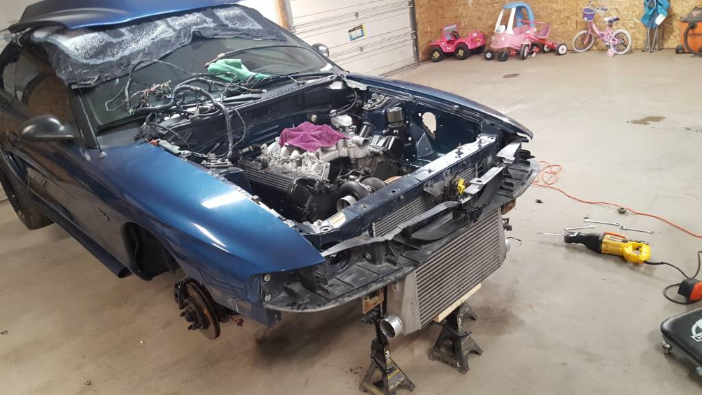

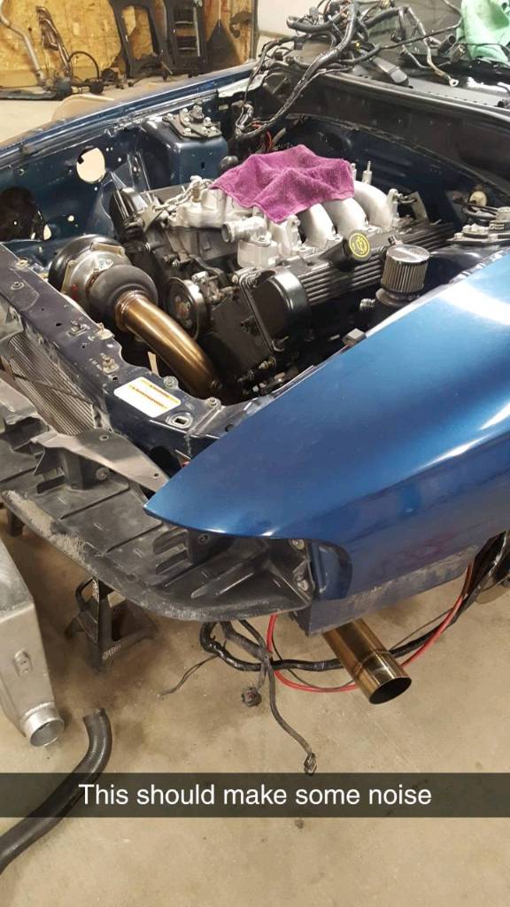

Some more mockup over the weekend. Chopped off the lower rad support and put the radiator where I felt happy with it. Clears the turbo perfect and leaves a better opening for the lower rad hose to clear the hot piping. Also mocked up the intercooler and looks like I will have plenty of room there too. Will be making measurments and fabbing my new rad/intercooler support soon.
Sent from my SM-G920R4 using Tapatalk
Looks great man! What size downpipe? Are you going to support the turbo?

I havnt measured the downpipe but I think its a 3". As for a turbo support.... I think we will incorporate something when we build the rad support. Have yet to decide how I want to go about it though.

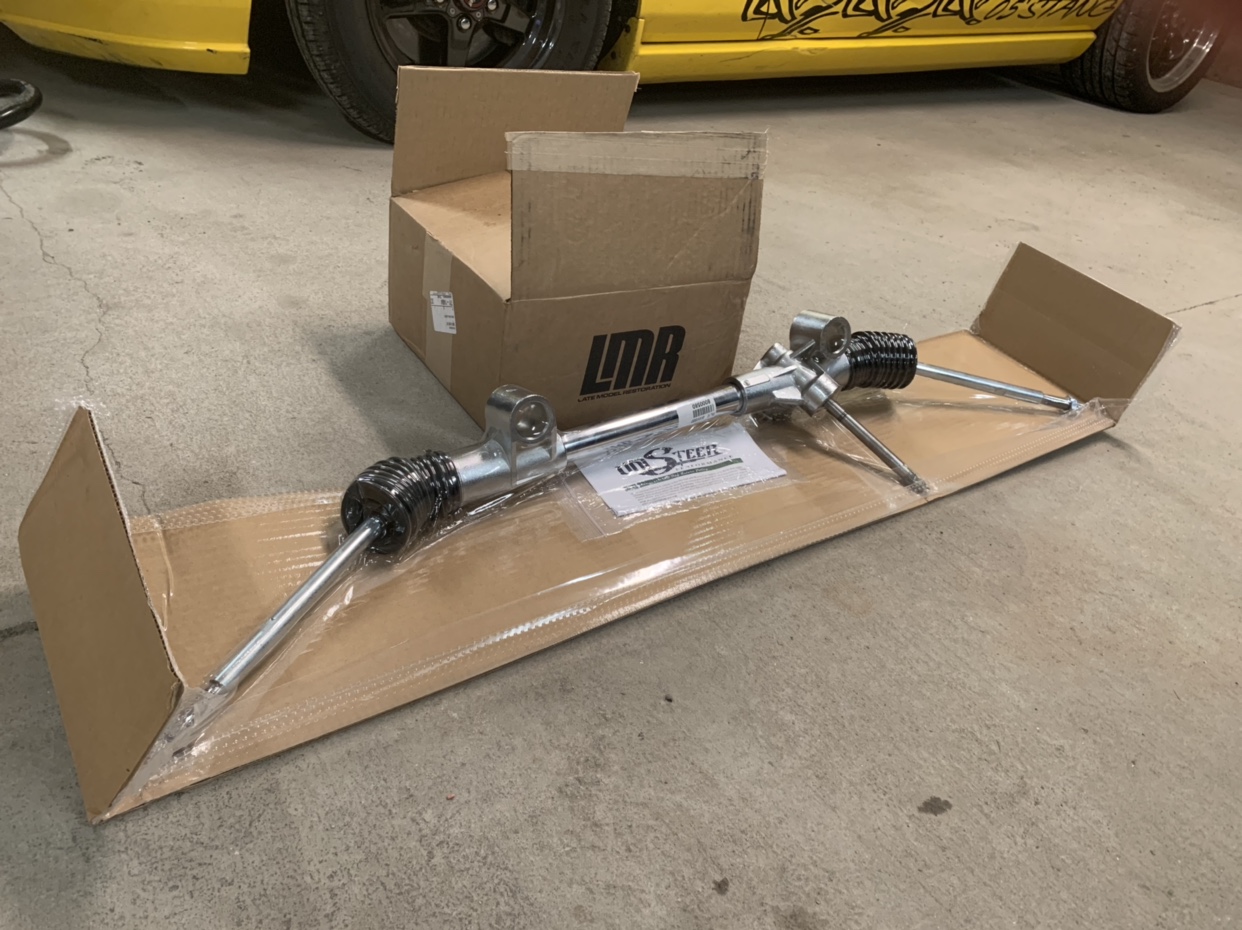

Black friday deals are upon us. Finally ordered my Manual Rack. Last thing to purchase is my new pump and fuel tank and we should be good to go.

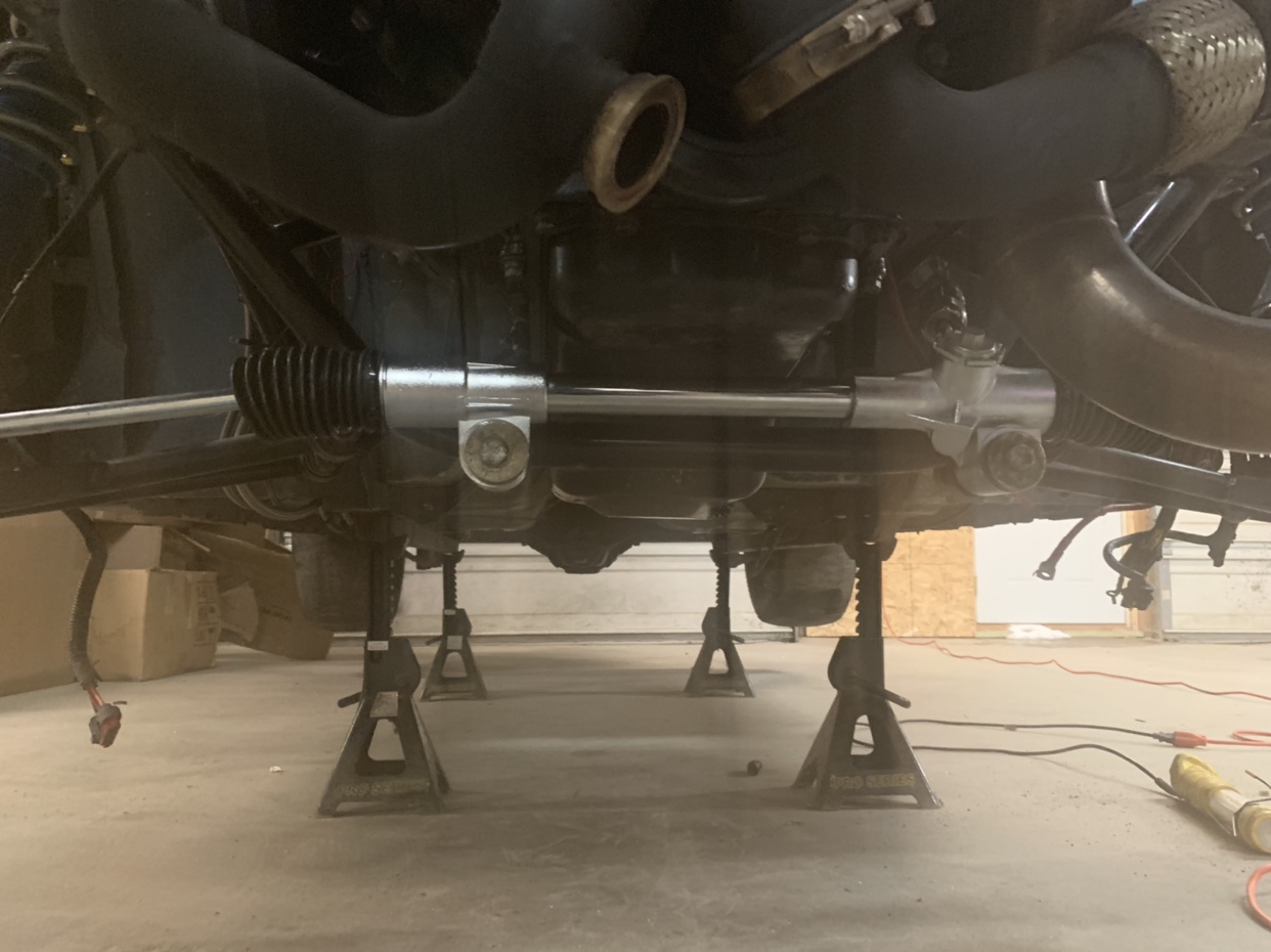

Manual rack is in. Gotta say the unisteer rack is a great piece and I really like how easy it is to install their steering linkage. Compare the price of their kit that includes everything to install down to the tie rod ends and that of the flaming river and it’s a no brainer.

I did something very similar with my core support. Ended up just getting some tubing, bends and fabbed up a nice lower loop for the radiator. I moved my radiator ahead of the core but do not have a charge air cooler to contend with though.
Looks like it is going to be fun! My exhaust even though n/a is going to come out in nearly the same spot. Though I still have to bleed the system after new lines I did the same as well with the MM manual brake kit. I set the pedal to the lowest point as well.
Its nice not having a bunch of lines all over the place, and to be able to clean up the clutter in the engine bay.
