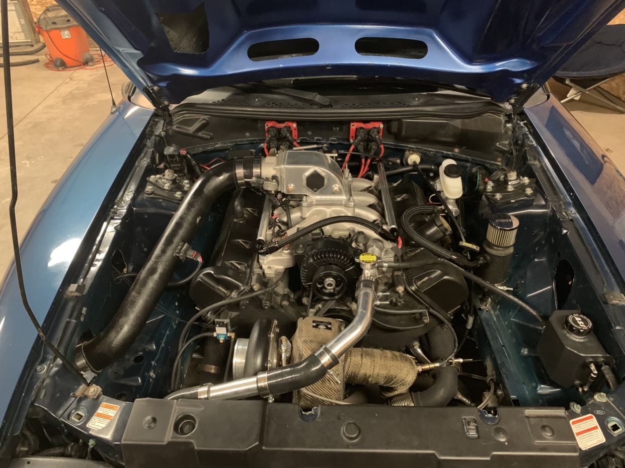

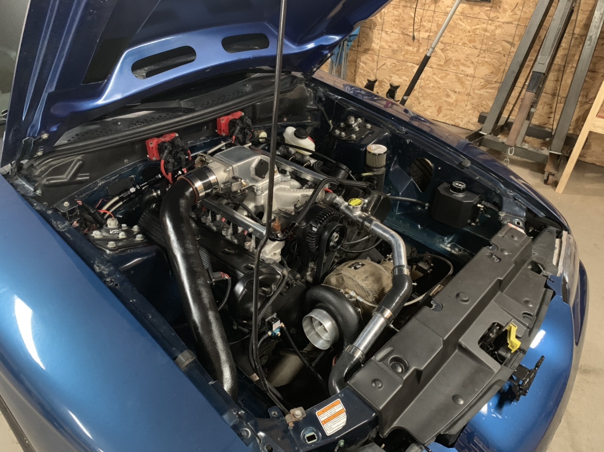

Really happy how this turned out....

That’s so bad ass! I’m excited to see what the difference is going to be. When do you plan to dyno it?
Ps: that fuel pump is crazy loud! Lol

Sounds healthy and the whole thing is tidy as hell. Great work, can't wait to see what this does on the track

Hell yeah! Sounds good brother. Looking forward to the spooled up 2 step clutch dumps lol

Sounds great! Aeromotive pump? Lol

Haha thanks all, yeah the pump is crazy loud.. Its a magnafuel 750 Protuner. I wanted plenty of fuel this year. Im going to call and get a dyno scheduled pretty quick.

Holy fawking hell!!! That might be the loudest pump I’ve ever heard!!!!! Lol
That motor sounds badass!! Definitely can’t wait to hear it spool up.
Odd, I run same pump and it’s nowhere near as loud. Running isolators?

I do not have isolaters on it... its actually mounted inside my Aluminum tank. Wondering if it being solid mounted in that is whats causing the loudness? Doesnt help either that I dont have a back seat divider yet.

I would not be surprised that the tank is helping it resonate especially if there are no isolators. You might be able to tone it down a good bit with just a small square of sound damping material in the right places if it really bugs you. Try putting your hand on the tank while its running and see if it gets quieter.

Come to think of it I think my 90 degree An fittings at the top of the tank are almost if not touching the trunk floor panel. That would for sure cause some noise.
