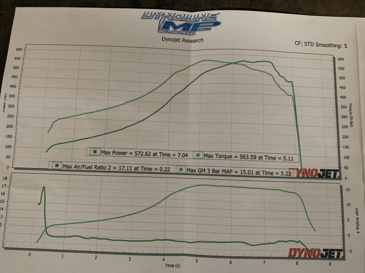

Dyno is all done. Not what I was hoping for. Kicking myself for not swapping out the blower cams. Anything up above 6500rpm the boost would start to drop. I’m also almost at the limits of the maf being pegged. Final numbers.... 574rwhp and 560tq. @ 15lbs and 15 degrees of timing. I feel like with a good set of cams and my maf being in a little bigger diameter pipe there would have been so much room to grow.

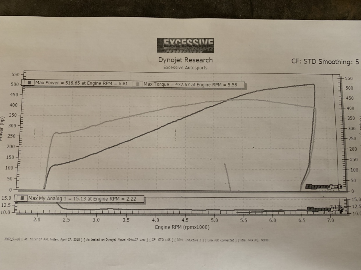

Still a major improvement over last year. Which it did 518whp at like 7000rpm and 430tq

That is right where it should be for 15 PSI, that means it is a competent design and build and a good base for more if you need it.

That looks like a 3” DP too. A 4” really yields big gains at those levels and even helps with turbo spool. What’s graph look like with those cams?

I’ll take a pic of the graph in just a sec. You can really see it drop around 6400 rpm power and boost.

Here’s a good cross comparison of this years dyno graph vs last years. Cams and a bigger down pipe is what should wake this thing up more. Should still rip at the track though.

Blower cams generally have a lot of overlap. Overlapping kills turbo setups.
I can’t wait to see what it does regardless though. Sounds wicked on the dyno
