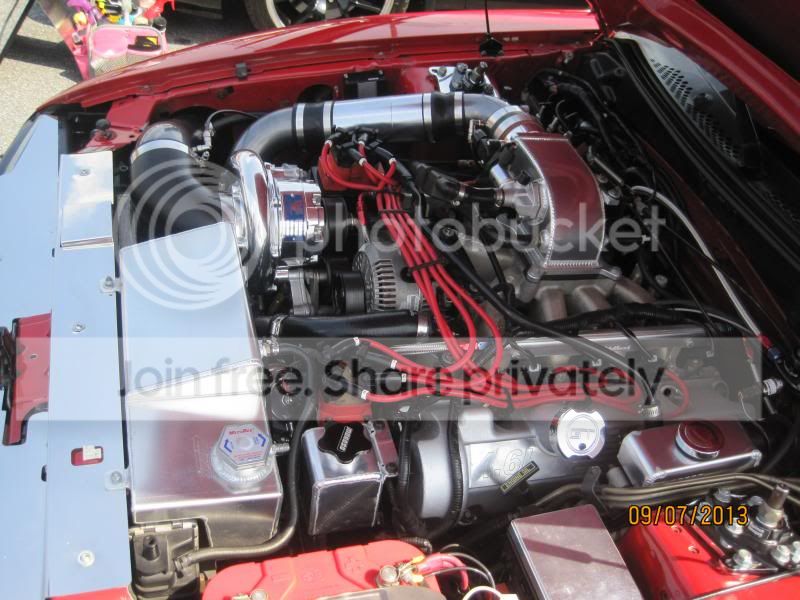

Man that is beautiful. What numbers/ET's are you expecting with the blower/meth/nitrous setup? How many lbs do you plan on running?
My setup is below. I'm seeing 20psi out of a V7 and run boost juice. I'm shooting for 700+ rwhp on a 100 shot if I go that high through a built auto. I already have my meth setup completely installed so I'll have to work around what I have setup right now with the plumbing of the nitrous:

97stanger Expecting 650+ from the blown stroker plus the hundred shot to put me in the mid sevens hopefully a bit higher with a bit of luck.
Combo is dart331, 8 ribbed Vortech si, meth and 100 shot. Ill run it for this year and decide if an upgrade to a cogged T or YSI will be needed.

Sweet setup for sure. A YSi would do wonders over that Si if you spin it more.
