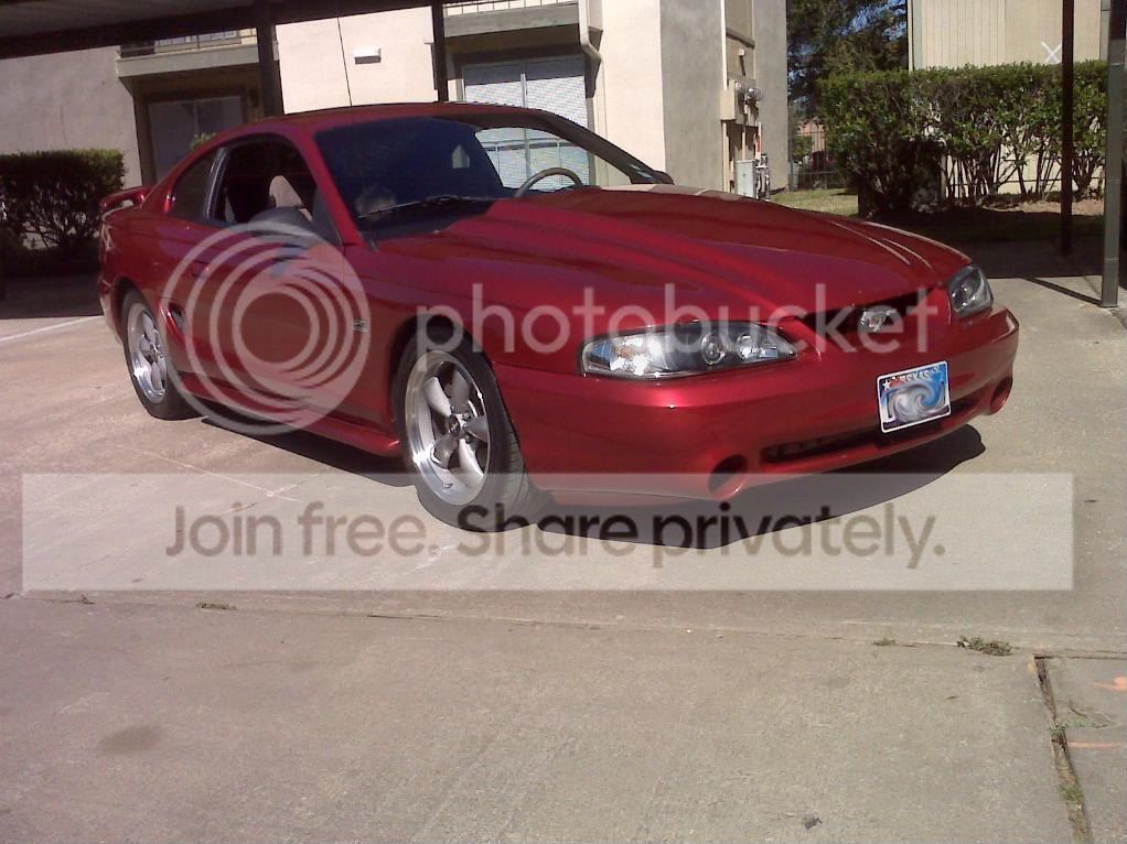

I have I think the same lights, housing as you. I have 4300K in mine. I run hidguy.net's in mine. I love them! I 1st ordered those ddm ones. Forgot the exact reason, I didn't get them. Maybe they were out of stock? I then was turned onto hidguy. Here's some pics of mine.
Lights I have:
http://www.hidguy.net/index.php?main_page=product_info&cPath=85_145_178_180&products_id=220
Stock:
HID:
This was the same night.
They really look like this to the eye.
