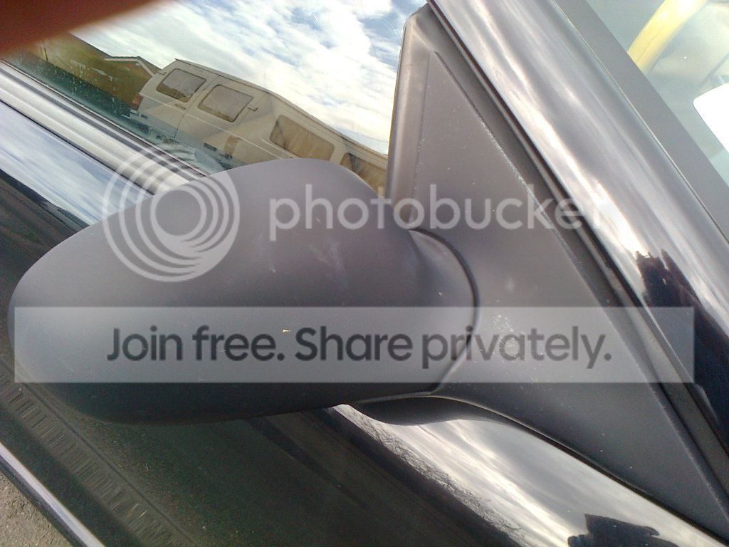

I have been wanting to do this for a while now & decided to go for it whilst i had the time.
Here is what they were like before,horrible & faded.
After
Just used rattle cans in my garage & i'm well pleased with the results.

What's a good paint to use on them and did you sand before painting them
Preparation is the key,give them a good wash first to remove any grease/residue & also rinse them off after each sanding,then dry thoroughly with a hair dryer.
I used 200 grit to rough up the surface,a flexible high build primer,600 grit wet & dry after each coat of primer,then base colour & finish with clearcoat.
I didn't try to remove the mirror glass as i didn't want to chance breaking the little plastic tabs,so just masked the glass off.I did dismantle the two sections to enable the paint to get a good coverage.
