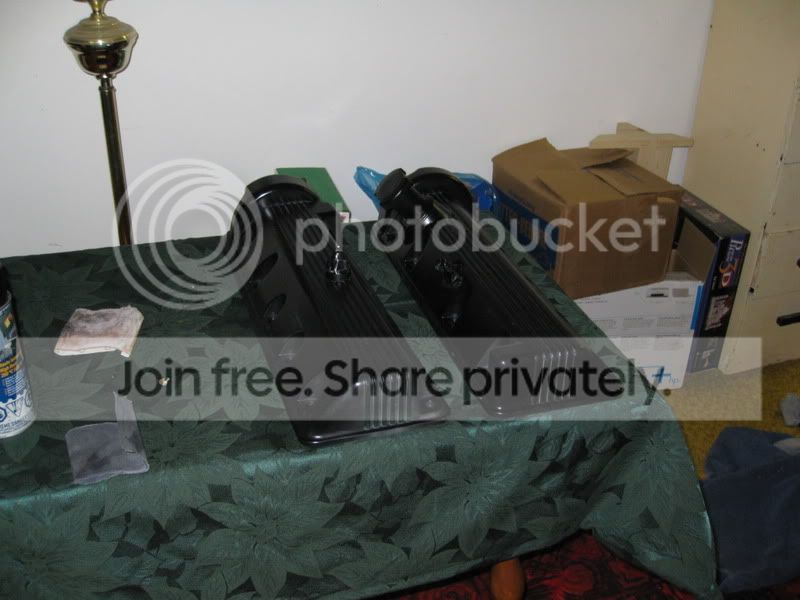

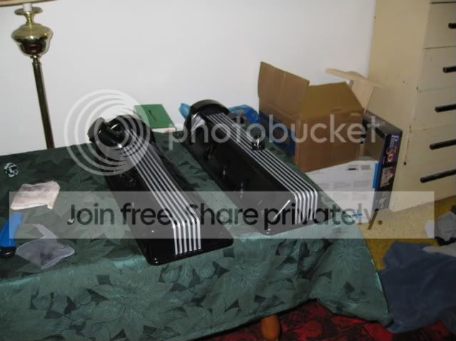

Just did it last month.
Some backyard expertise:
Degreaser, silver paint, taped then black and touched up. all high heat.
