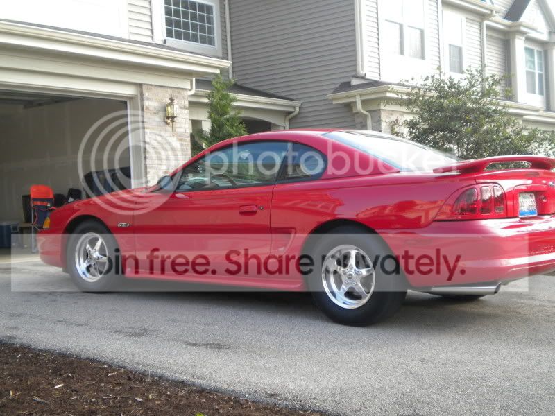

Track trim.....
Street trim......

I love the look but it feels like driving a boat on the street. The front Kuhmo tires look flat even though there filled to 40 psi.

Mixing radial tires with bias tires on the rear will make an unstable feeling while driving. Put a set of Mickey Thompson Sportsman front runners 1572's or 1573's on and the boat feeling will be gone. The car looks great thou. The way your car is sitting, (tires looking flat) I would have an alignment done to see what you have. Keep up the great work.
