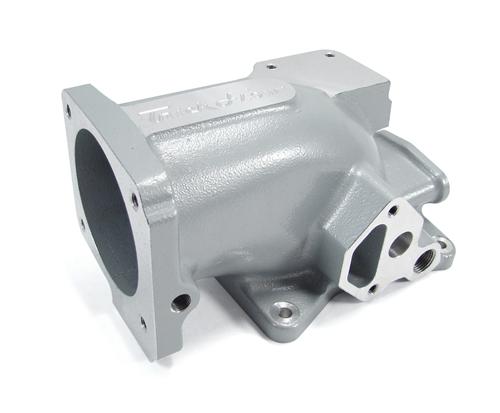

never heard of anyone having a problem with TF TBs/plenums.

I've never had any trouble out of my TF plenum. I don't recall anybody having problems out of Accufab either. I like my TF, but if you went either way, I don't think you would have any issues. AM is a good company. Good customer service.

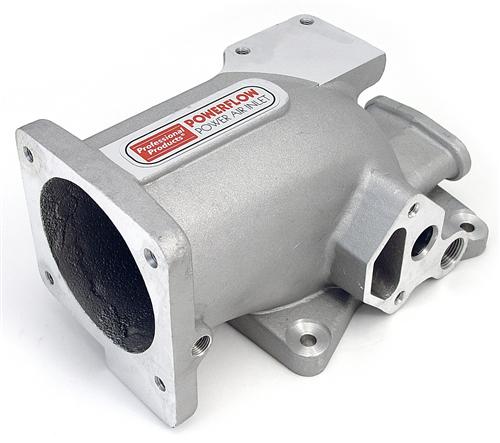

other than C&L, BBK, and accufab, most TB/plenum combos are the same design. they just carve the throat of the plenum differently.
trick flow
Pro products

I had the Trick Flow until I went with the Reichard Racing elbow. Nice piece with the t/b on it and worked well for me.

personally if i had to go back i wouldnt get the professional products kit. the plenum needs to be polished on the inside. it has a real rough casting(unlike the outside that is smooth as a babys butt..lol)

i had the professional products piece. i dremeled .25 material inside all the way around to be smooth. the only thing ill complain about is the EGR port doesnt have a fin like material to guide the incoming charge. what i did wrong was open the intake mouth too much in length. i had to black permatex it on the intake. it didnt have any leaks but it would not use a stock gasket seal.
