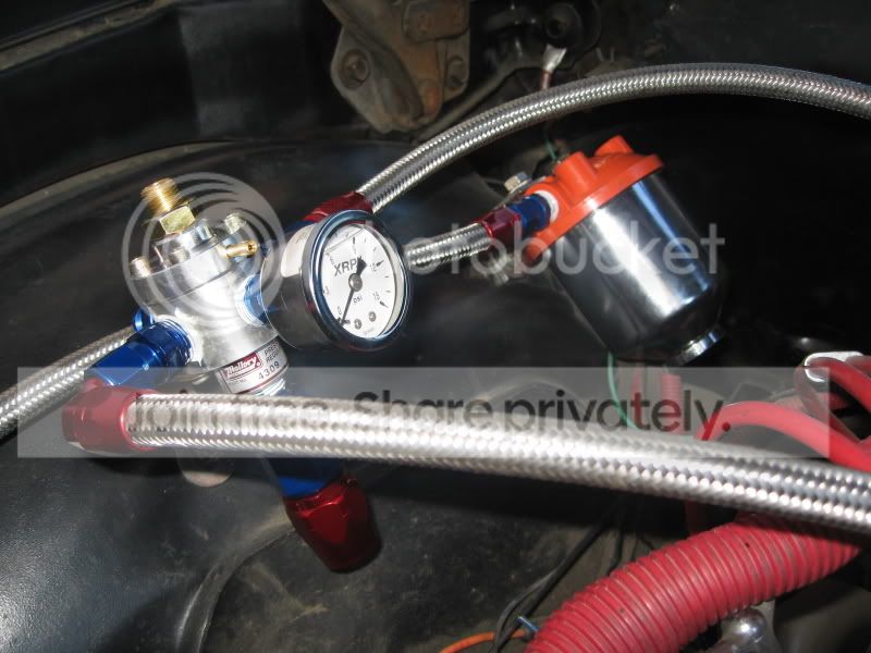

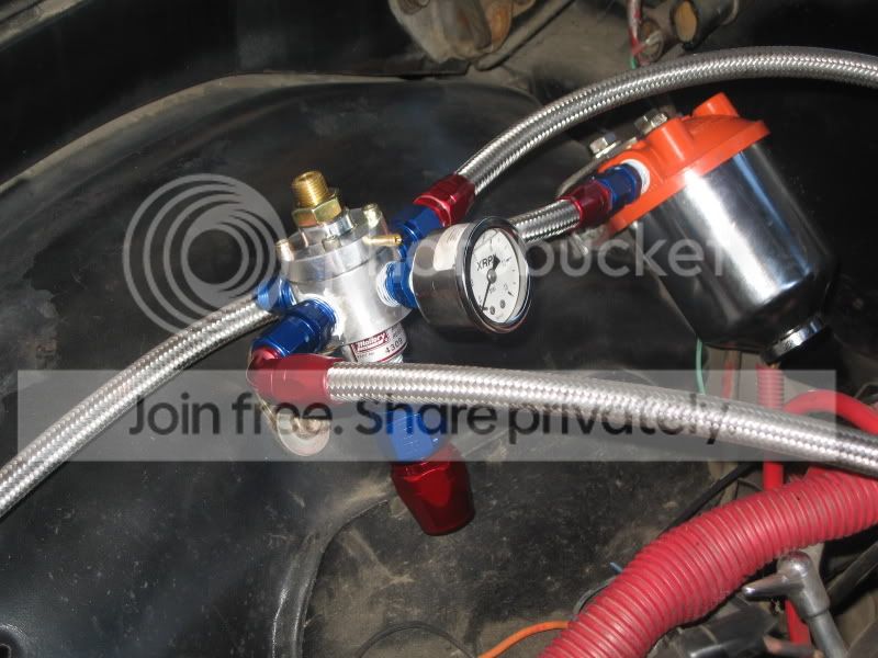

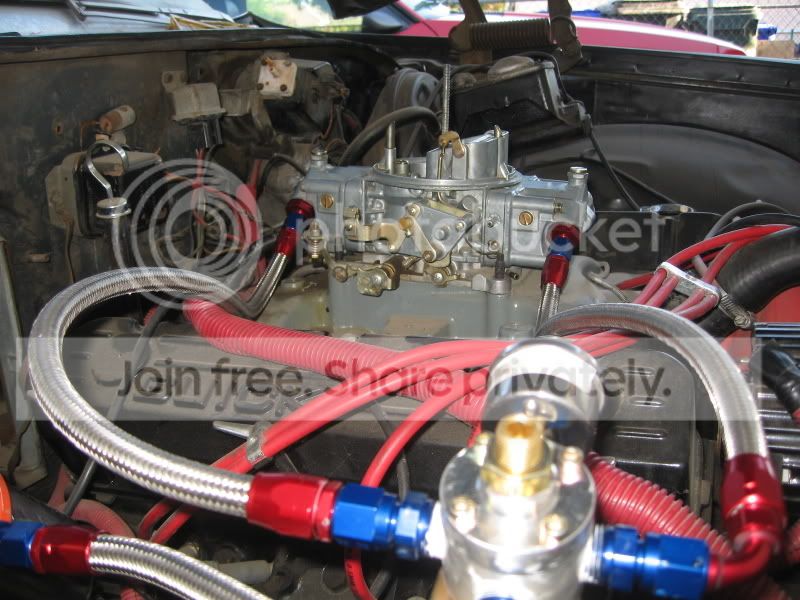

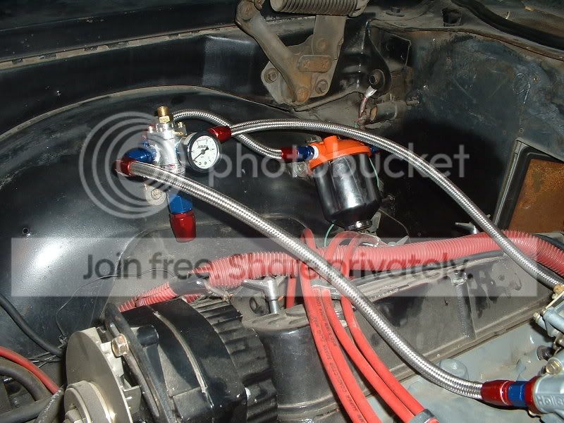

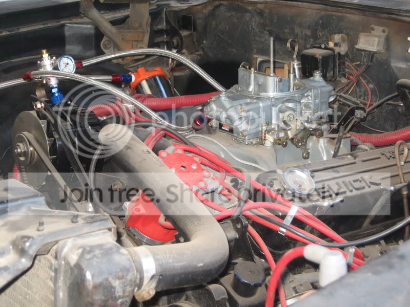

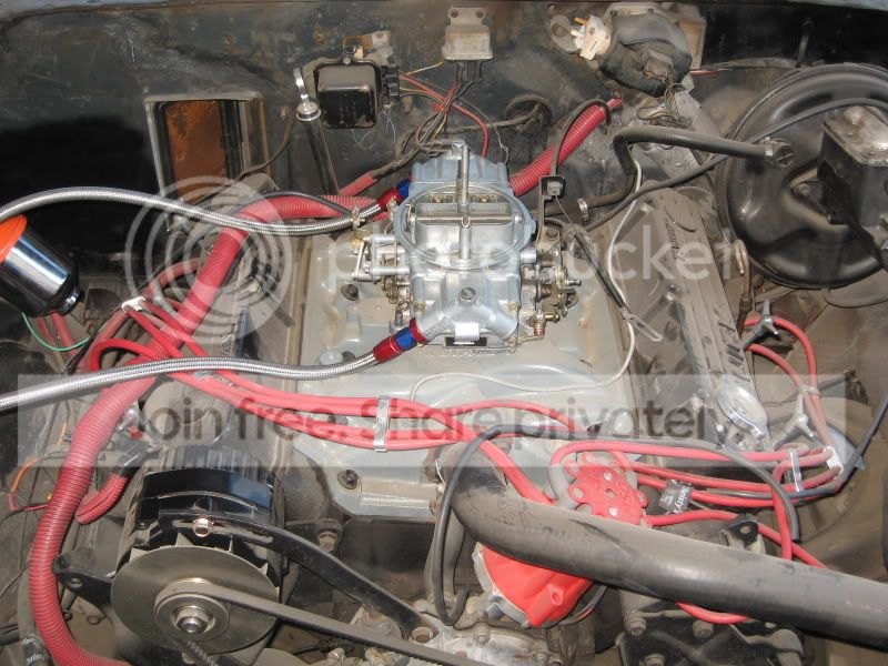

ohh man i been busy lately but, heres the progress. right now im redoing the whole fuel system. i yanked out the whole system including tank and lines. i got a 160gph edelbrock pump, mallory return style regulator, fram canister style filter, 3/8 fuel inlet line, and 5/8 return line.im going to buy the 16 gallon fuel cell this weekend and the rest of the steel braided hose. i got most of it and most of the fittings, but still need some more.enjoy.........
old fuel setup
new fuel set up in progress
fuel pump, should be enough to feed some nitrous :naughty:
and the fuel hard line

a 90 degree angle fitting woulve looked a lot nicer on that feed line coming out of the regulator ::) j/k. finally after years of being ignored. mustangs get adicting dont they. its coming out really nice. O0

i knew u were going to talk crap about my straight fitting ::)

Ah, there's my comfort zone, a carburetor. O0

Sorry I am not up to speed on my GM engines by eyeball, but is that a 350?
I suspect that with the bigger carb and that fuel line that it is built for upper RPM performance? The 750 is a good sized carb for this sized engine, presuming it's a 350, when built for upper RPM duties. If the engine is built otherwise that may be too much carb for it.
