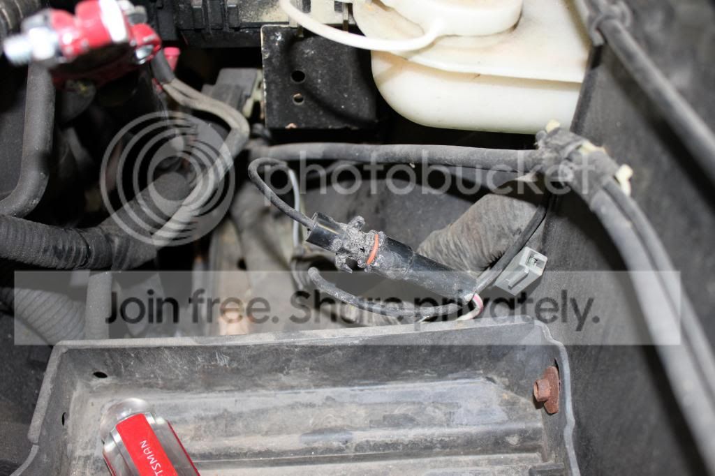

What are these? And what are they for? help appreciated!!
driverside fender well...

top one is probably fog lights,
second one is probably ABS,
third one i dont rember, but they have them all the way up to 2004.

Are there any aftermarket kits that utilize said obvious connector flapping in the breeze?

I cant tell if their kit includes the wires. dammit. Ill figure this out haha, I think it may be wise to get some used OEM assembly off ebay... MMM.... ebay special.

Yea Chris is right about the abs ones. That bottom one that little grey plug is unhooked on every 5.0 I've seen

I was referring to the burnt looking thing in that last pic, but hey, good to know! Thanks musty!.... er. 'turd. um. Musturd. ;)

Yea that's plug goes directly in the bulb buddy. You'll see them on both sides

Derp on my part. You the man. Thanks guys. Im gunna assume that third pic has something to do with evap. assuming its got a vac line running to it. I just looked at it a couple hours ago but I can remember cuz im so burnt out.

All the evap stuff is on the driver side. That lil grey plug is for diagnosing the abs along with another plug. That you don't have out I don't see. All the cruise control stuff is also on the driver side fender..
