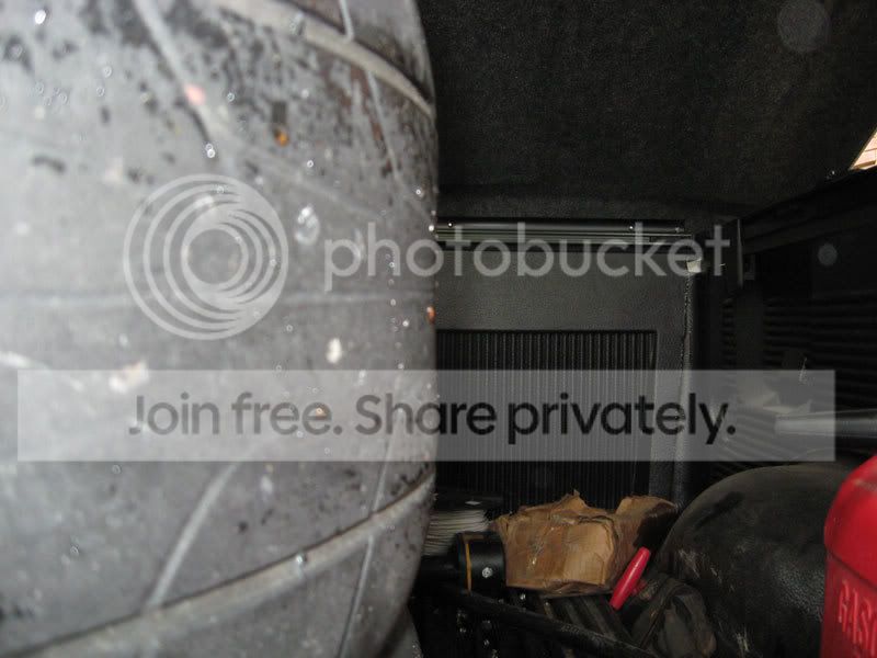

Went to the track this past friday and still couldnt cut some good ET's but thats another story. Well this morning i was loading up his drag radials to take them over to his house and noticed this...
What you're looking at is the inner bulge of the tire. Is this normal, or could this be why we havent really been cutting good times on these tires. The rims are stock 99 cobra rims and the tire is a 275 size nitto drag. My best 60 i have been able to cut on these tires is a 2.1. Or am i not holding my mouth right?

if you want traction screw junk drag radials and get slicks....but if you like radials then keep them around 20-25 psi and do a good burnout to get the compounds warm

yep they've got too much air in them, 555r's seem to wear the best with about 22psi. they hook the best for me with about 18psi and a real smokey burnout, they need to be HOT.

hmm ok cool. I dunno what psi we were running but i know its over 20 something. I'll recheck them next track day and go from there.
