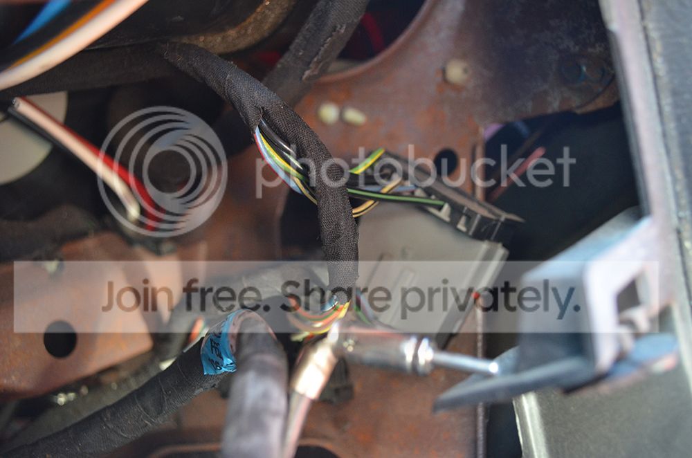

pull the radio and take a picture of the wiring for me.
Here's what I could manage to get.
I noticed this yellow wire leading to the pigtail seems to be pretty loose. That wire is Memory 12V+.
32,616
5,653
it looks to be wired correctly. A loose wire in the hrns would cause it to not work, or work intermittently but it would not make it turn on with the key off. If you have a volt meter or test light stab the red/yellow/black wires with it with the key on to confirm that there is power on the red/yellow with the key on, and that the ground/black wire is a good ground.
