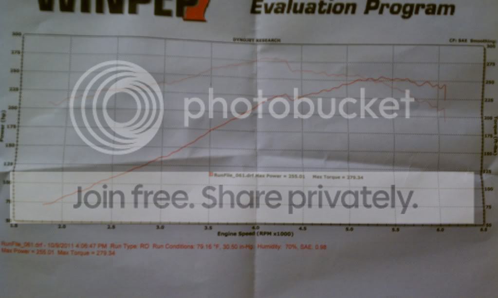

went to a dyno day and show. got the car re-dynoed for the first time since i did my delete plates.
made 255rwhp and 279rwtq. picked up 47rwhp and 22rwtq since before the deletes. same dyno as last time but it was hotter today and very humid. it is also untuned for the deletes, so i will gain a decent amount from a tune as well.

Because the timing doesnt advance to make up for no IMRCs...all in the tune lol.

Good stuff Ryan glad you got it fixed. Those numbers still seem a bit low for the mods that you have done even if it's untuned. Are there any other problems you know about?

If I remember correctly the guy said there was a lot of vibration coming from the rear end so he didn't want to push it much.

Doesn't make a whole lot of sense. WOT on the dyno is WOT. what I am noticing is the lack of smoothness above 4k rpms, either that's the lack tuning for the imrc deletes or a spark issue like the coils cutting out.

I was thinking a spark issue myself! Ryan, have you thought of doing the c.o.p. swap? I noticed a nicer and much smoother sounding idle...

not really interested in COP's, coil packs should be able to support way more than my bolt on car. i have a spare set of coils too.
i believe alot will be gained back from a tune. from the looks of my graph; if that dip wasnt there, and was smoother, it looks like it would hit about 270hp and it would keep some more torque up top. i can live with that.
im quite content with knowing how much i gained back from the deletes, which were essentially free.
the car is not quite "there" yet, but it's on the right track, which is what i wanted to confirm on the dyno
