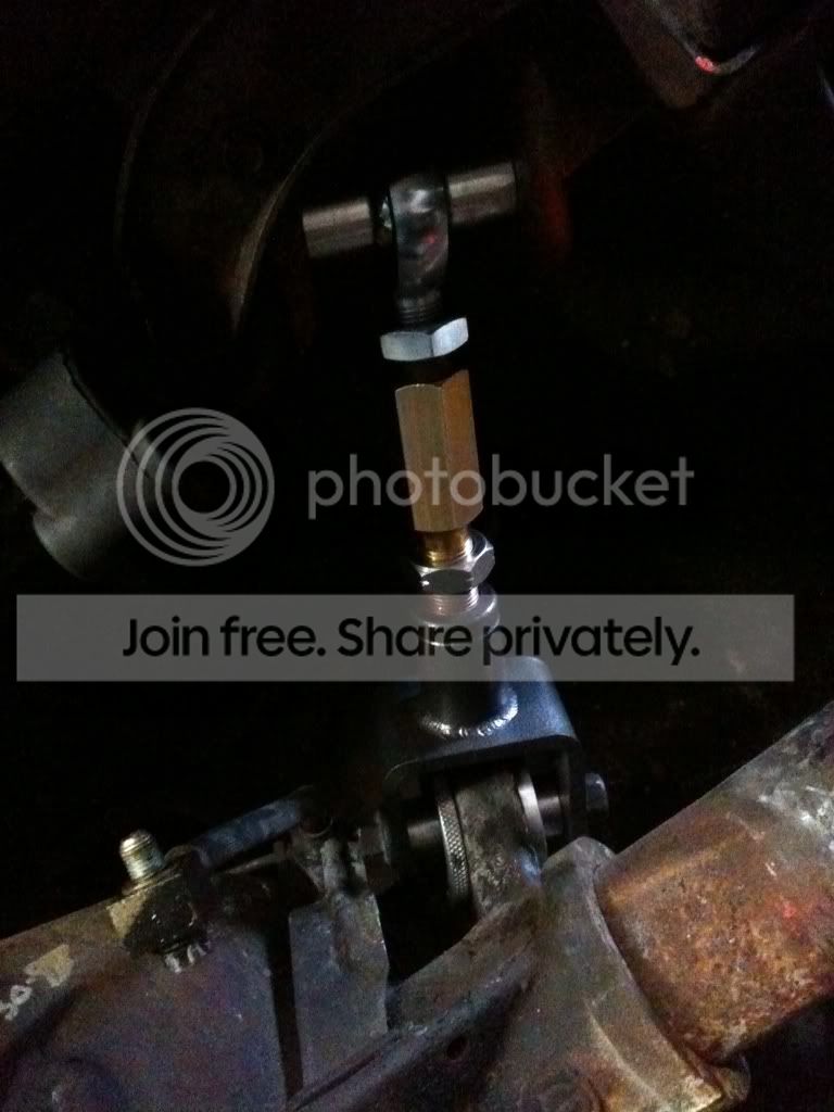

adjusting the pinion angle will help improve the angle of your drive line and how it plants your wheels to the ground. Its used as a benefit to drag racing. Yes you need adjustable upper control arms like this.
and you need a magnetic angle gauge
Basically when you turn that center turn buckle on the upper arm it will shorten / lengthen the arm which will point your rear end down or raise it up. You make equal adjustments to each side until you get the pinion angle you want then you turn the other bolts on the arm to lock it in place.

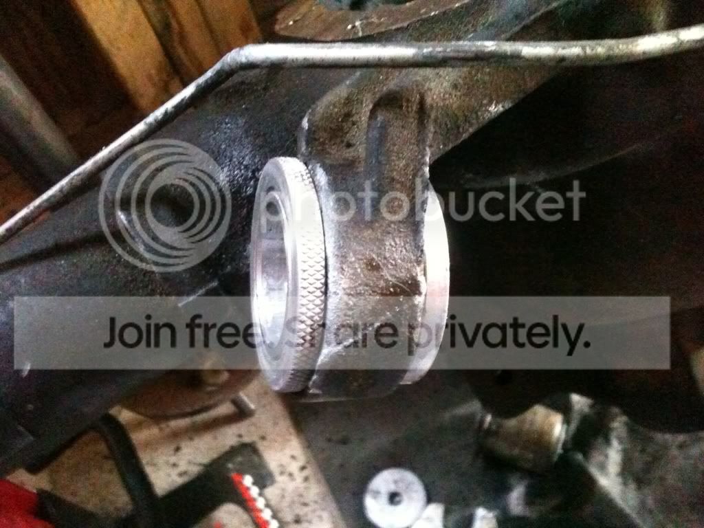

if you want to replace the bushing you will also need a bushing removal tool from Maximum Motorsports
I replaced mine.

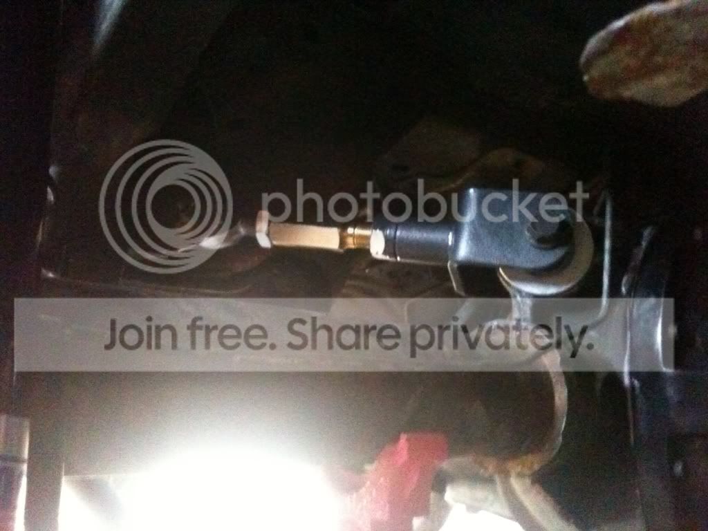

and here is a better shot of the control arm.
