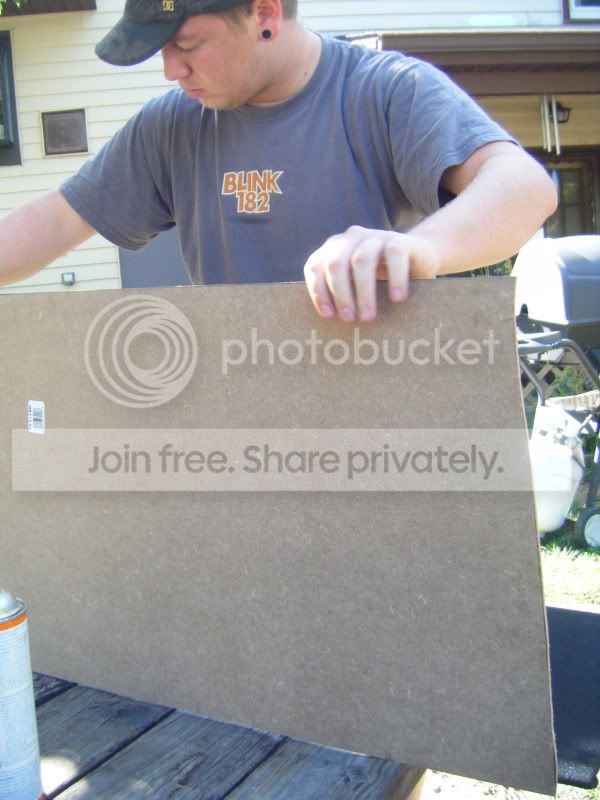

Trace the template on to the MDF
Then you cut out the mdf

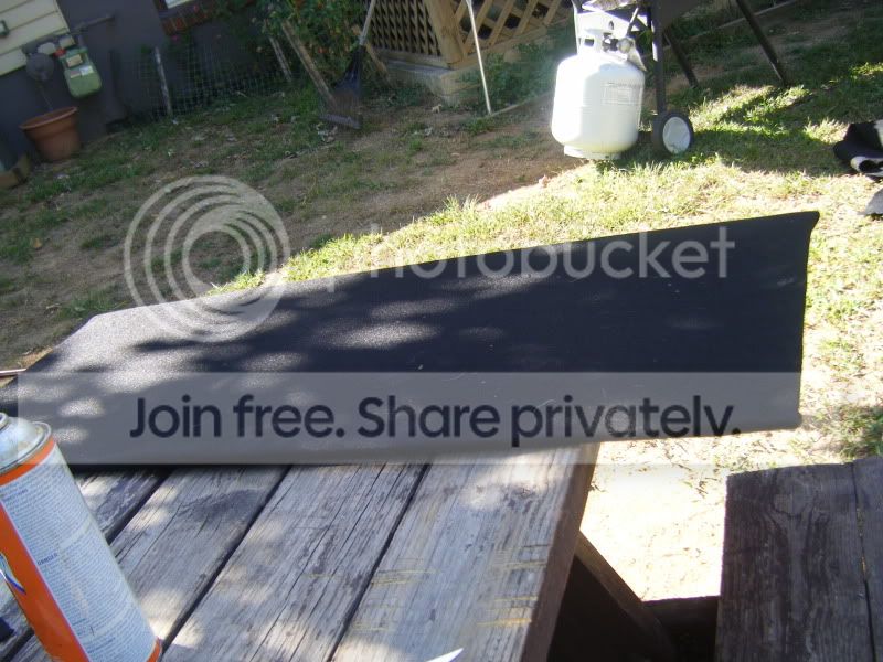

Bottom Finished:
I then Drilled holes to attach the L brackets to the seat back with flat head machine screws. I attached the L brackets Then i covered it with carpet so you couldnt see them... Its been finished but i didnt take a pic of it yet. Didnt think anyone would be interested.
the 1/4'' MDF keeps it light. I used a lint roller to clean all the leaves off of it. It was just to nice to sit inside... If my g/f would come watch me do these things more often id actually make a full write up on something.
