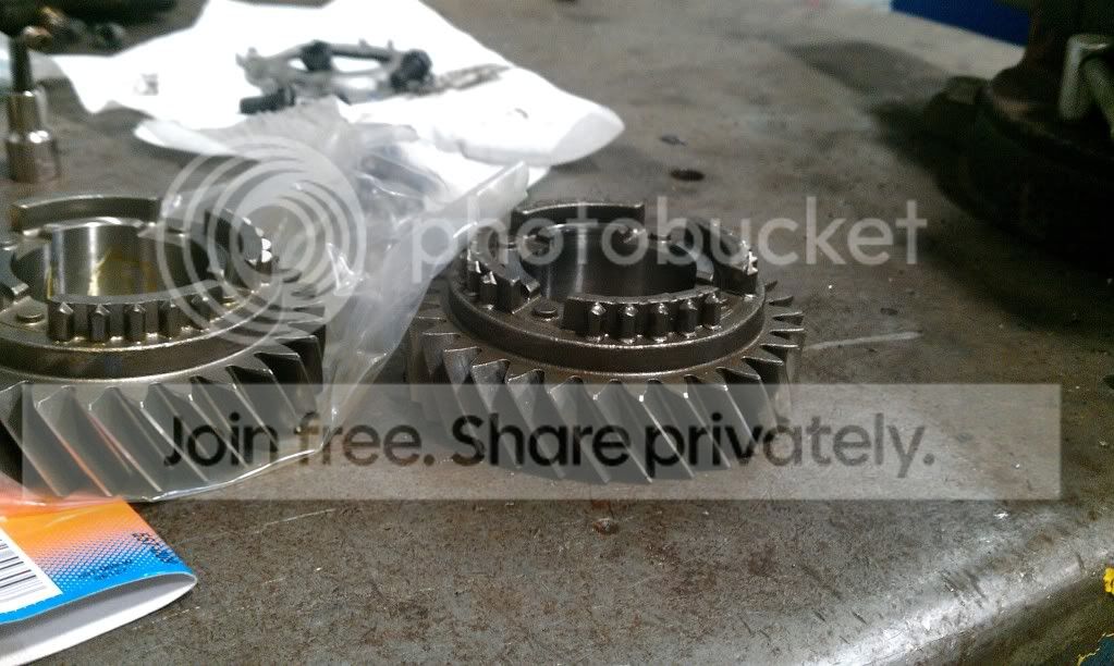

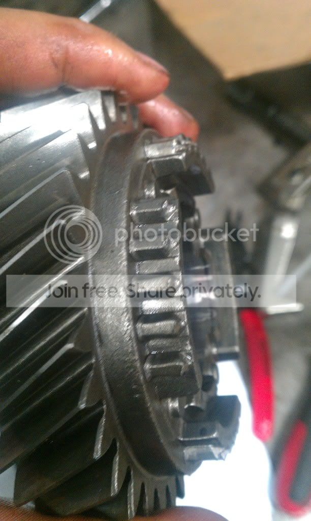

New third gear from Astro on the left the right one is the old one.. Tips were becoming rounded

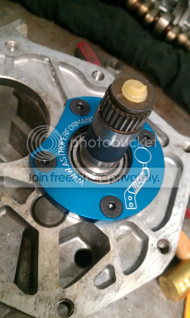

New Astro Plate
better look at third

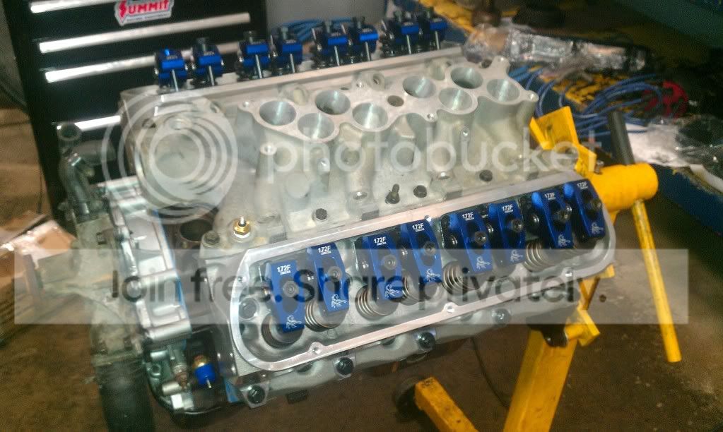

Ok got the engine all put back together basically today. Trick flow heads, tfs1 cam, trick flow pushrods, cobra lower (ported by tmoss) and those nice looking blue scorpion RR.. I like them they look great but the fact that i got one of the retaining nuts in a 1/2 instead of 3/8 kinda makes me frustrated but anyways new one should be here say tues of next week at the latest.. Next thing to do is tackle the rest of the trans on monday and start putting her under its own power by next friday.

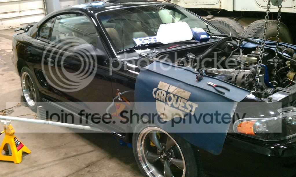

Back from the body shop
transplant ready
Fitting and wiggling
BBk LT were just a little fun trying to fit Just a little...
All in now everything needs to get back on..

love the look of the headlights, but it seems the corners are being pushed out?

Yeah the headlights right now are not in all the way. They were being held by one nut. Had the front bumper taken off and resprayed also when they fixed the door and rear quarter. Yeah i need to work out a few issues but i hope soon to have a few new videos of it up.

Can´t wait to see some close ups of the headlights when they´re in properly.

That stuff looks good but i dont think i would use it in my tranny. After rebuilding it and figuring out what is what inside. There are two blocker rings 3rd and 4th that have a carbon fiber material on them. Its to help slow the gears down so they align quicker. With something that nice in there you could have a issue with high reving shifts. I know right now i can do a 3-4 gear change at about 5200 rpm way smoother then before.. I know i changed the gear and also put the plate on there to help with countershaft stability. With those alone it changed the feel but i know i was running amsoil full synthetic in it and my 3/4 switch was sometimes a little bit of a issue.

I find that it wasnt the blockers that got worn at all but the actual metal as you can see from the 3rd gear above. Looks like a lot of higher rpm jamming was involved and the blockers are what caused the damage from missalignment when shifting.
