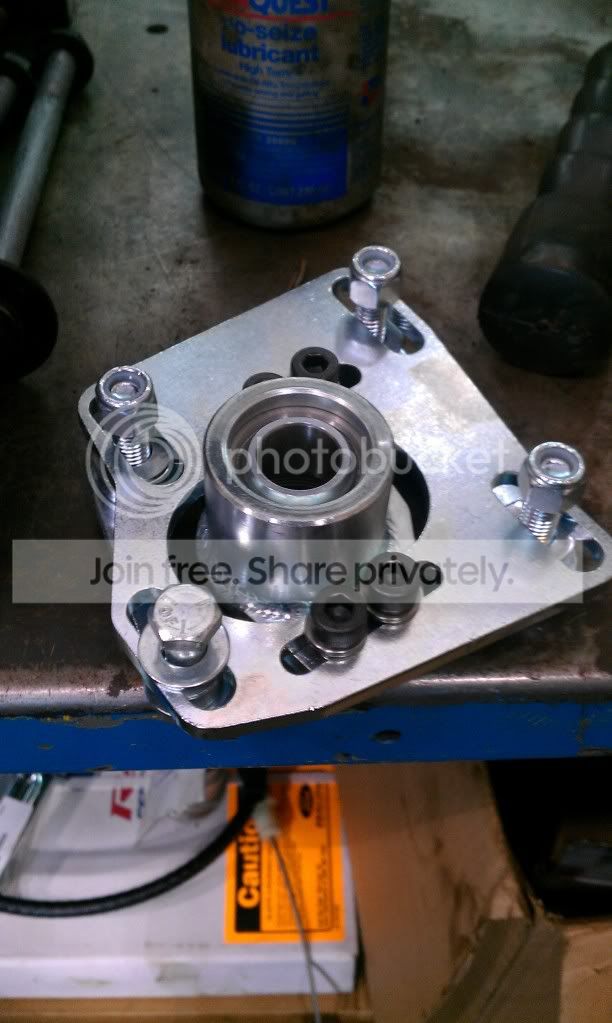

When installing my springs i should have looked futher indepth to the process and into more how it effects geometry of the cars front end and the change in pinion angle.
Upr caster camber plates if you go more then a inch these are going to be a wise choice.

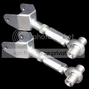

PINION ANGLE!!! If you dont know about it read up on it.. Anyone wanting to go lower should understand it before doing it. Its not hard at all and actually asy concept but talk about driveline vibration.
After doing my rearend with everything even after the correction of the pinion angle i still had a slight vibration
Eithe one of two options you have either go get it balanced again or better yet get a aluminum one.. I will have to say the gears,short throw, and this driveshaft sure make it a little more rev happy and your smile huge. There is a noticable difference in the feel of the car maybe not much in the actual get up and go.

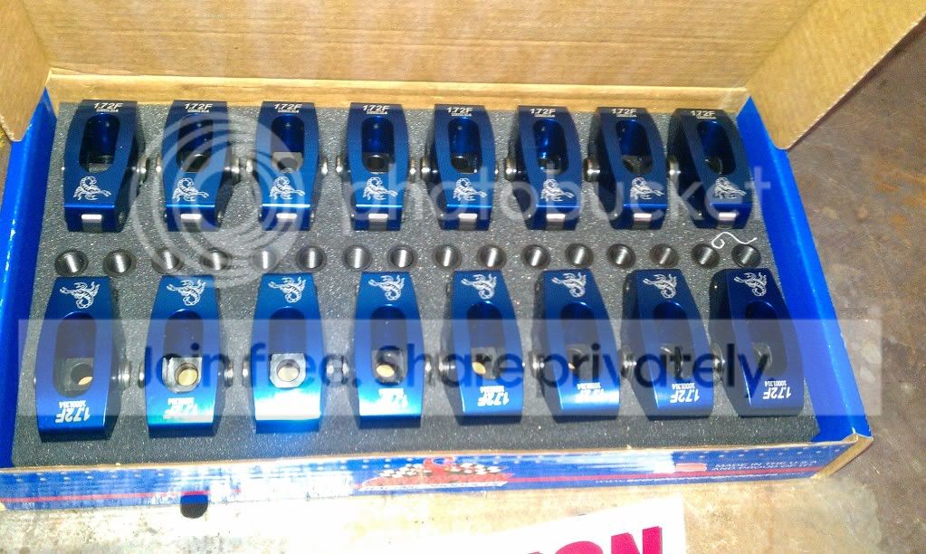

Yeah but like a bumbass i totally overlooked the pedestral mounting dont work on trick flow and do on afr :( so that little im going to spend on the new rockers could have been for those arf.. OH THE SAME.. Someone hit me lol..

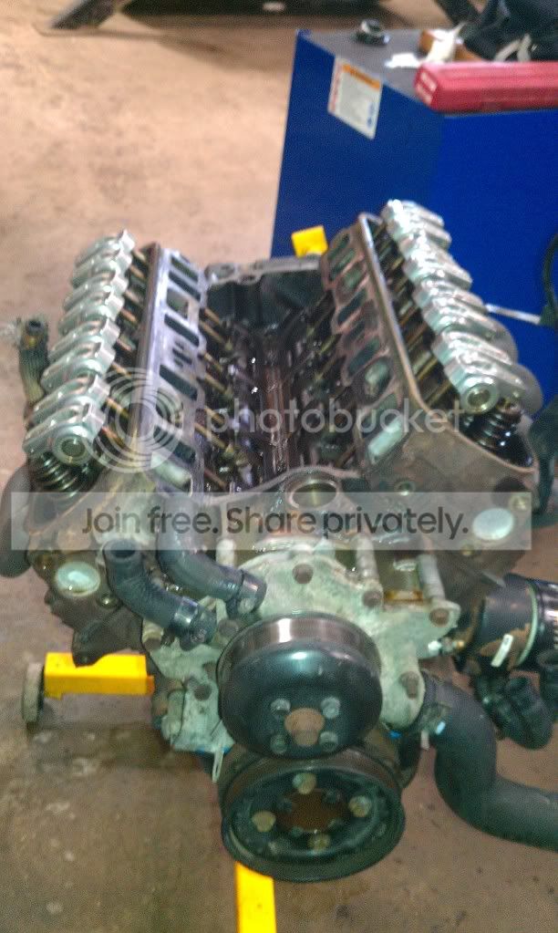

Engine In looking all nasty... But still loveable.. No not ok to be a snake and loveable...
Engine and tranny out.. Now time to degrease and send it off to get the door fixed while i go and start the teardown of the engine and tranny..

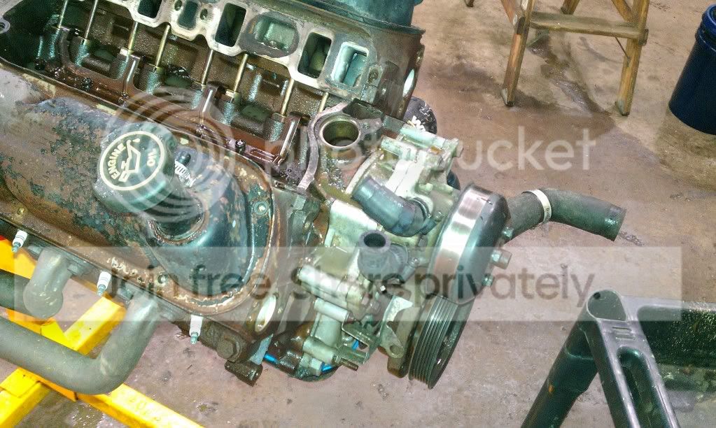

Ok engine is out and starting to come apart and its just sad.. For 95K on a cobra you wouldnt think there was this much crap on it...

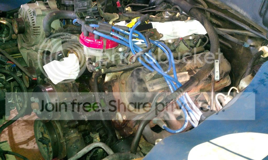

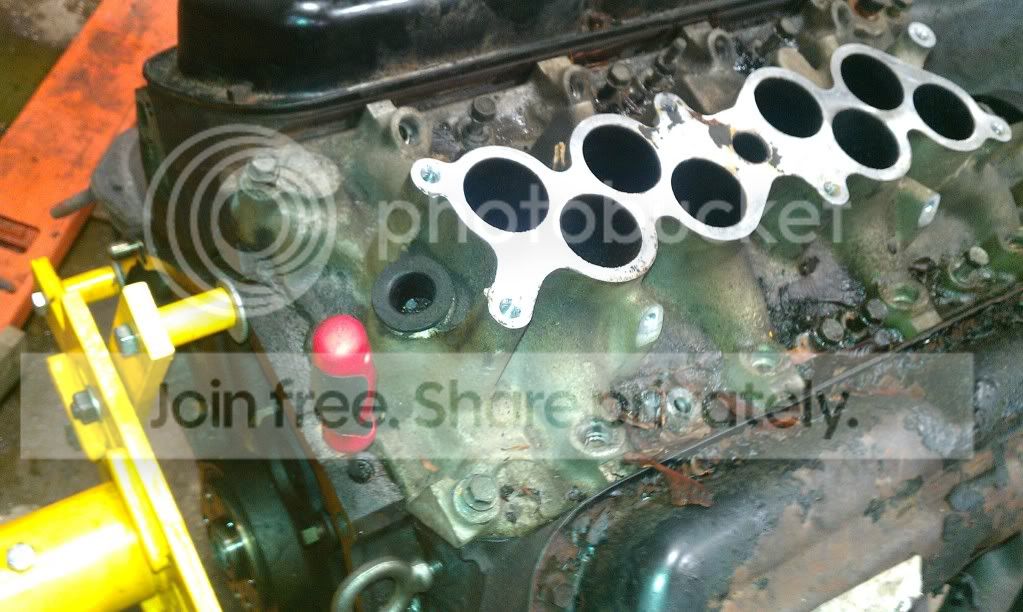

Did a little cleaing with the pressure washer. Loaded the valley with towels and then taped over.. (kinda crappy but no lower intake to use) work great btw
Came out not to bad at all.. Now more tear down..
Scorpion 1.72 RR STUD MOUNTED GRRRRRRRRRR

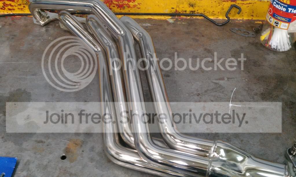

Presents from BBK with a nice set of LT and matching Off road X
