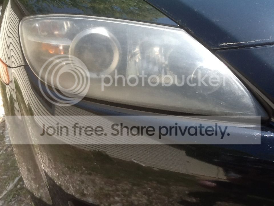

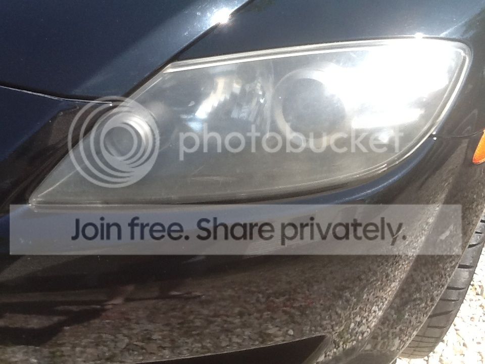

Go to a store and buy an avocado. Peel off some of the skin and smear some of the avocado on your headlight. Take the inside of the skin that you peeled off and scrub your headlight with it. Then wash the avocado off of your car and be amazed at the results. I did this to my girlfriends rx8 lastnight and they went from yellow to 95% clear. This method won't get your headlights show car worthy, but for a DD you will be happy and for less than a dollar your headlights will look 100 times better. I didn't take any pictures before i did it because I didn't think it would work.
this is not her car but her headlights where this bad.
this is her car after the avocado.
