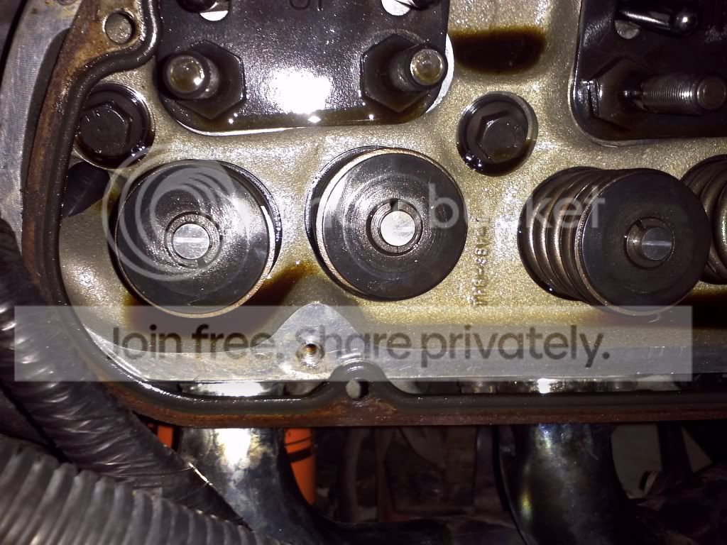

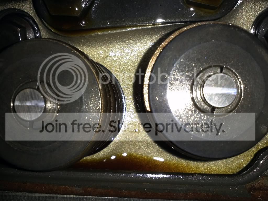

So after finishing the car the rockers have always been a little noisy. I have adjusted them once and they did not get any better so before taking my car to get dyno tuned Tuesday i wanted to try to fix the problem ..
I have driven the car over 1,000 miles with no problems and the car runs great so here are some pictures of the springs
Please let me know if you think i need a little longer pushrod ..
They are 6.7 and i was thinking of going with a 6.75
Some look great some look a little short

Wear looks to be near the center of the vlv.. what's the prob?
Are you running solid or hydraulic lifters? And how are you adjusting the vlvs?

it looks good to me too. what rockers are you running?
Ford MotorSports 1.6
I think i found the problem ....
When I installed the roller rockers i put the flat side of the rocker on the bottom and not on the top so the nut can set on it...
I swapped it the right way and will see when im dont if it makes a difference .. lets pray

those rockers have been known to be noisey in some cars..

looks good to me, my ford rockers were loud too, even with the same pushrods on same motor they were louder than my scorpions by a bit.
