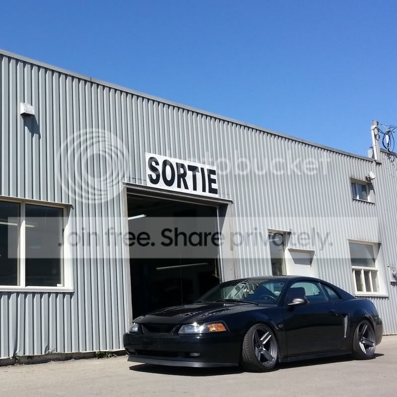

Wow the car looks amazing! i was unsure of the 4 spoke rims, but they actually look sweet! Love the car.
Good luck with repairs!

What size and offset? Did you run spacers with them?
the silver one
18x9 et 20 all around no spacer
the 4 spoke
18x9 et 15 front + a 25mm spacer wich comes up to 18x9 et-10 225/40r18
18x10 et 15 rear no spacer ( i'll be adding a 15m spacer eventually 235/40r18

Ok thanks! They both look great on there!
On there site I only see the silver ones in 18x9 +20 with a 5x100 pattern.
Also what is the pricing like for their wheels?
Sorry for all the questions I just really like them!
