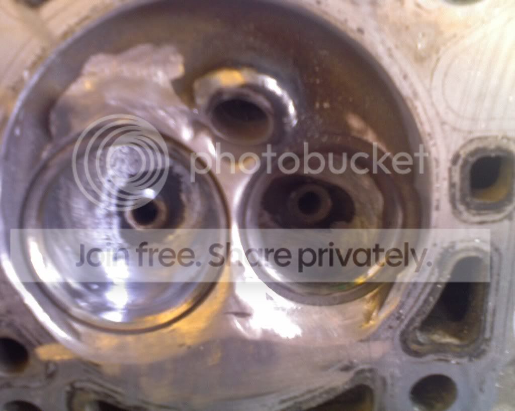

A pic of the reworked combustion Chamber. The Spark Plugs will be indexed as well when i assemble the motor.

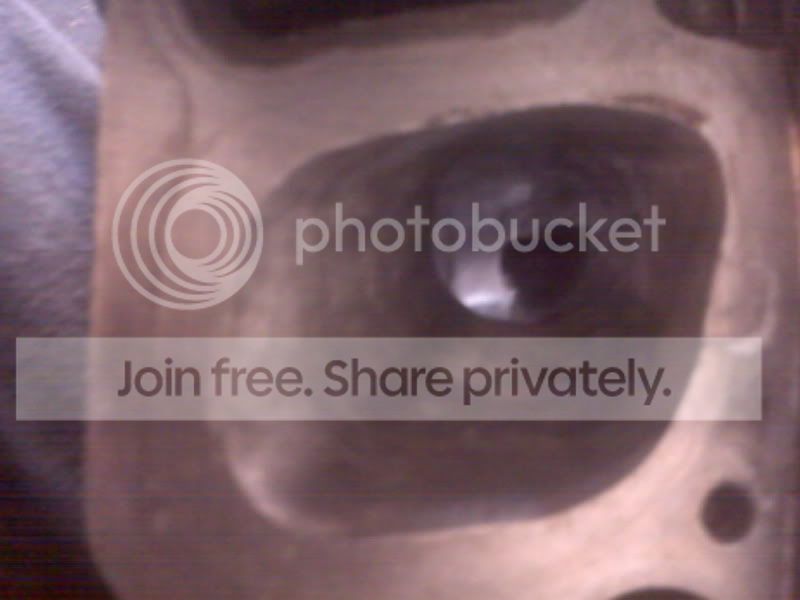

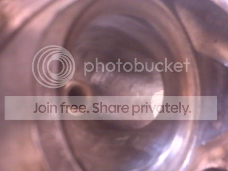

Pic of the intake port from the valve side
Intake runner side on the port

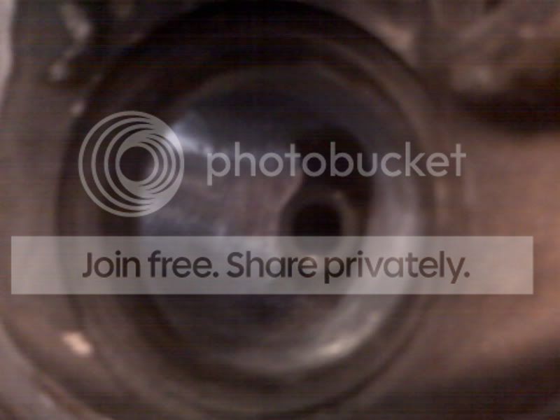

And the Exhaust ports, there wasnt much they needed other then a bunch of valve shrouding removed and a ton of polishing
Header Side of the port
Valve side of the port

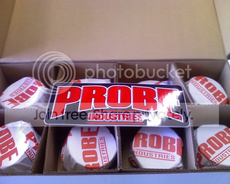

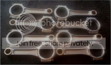

Now for the rods and pistons. I Went with Forged I beam Rods and Probe 10.5cc dish pistons. These pistons should yeild me roughly 10.5:1 Compression, and the rods should be good till around 600whp. Also i got bored so i polished the connecting rods

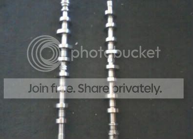

I also have a set of manley Nextek Valve springs and a pair of comp XE270AH cams for the motor and an edelbrock Victor JR intake
