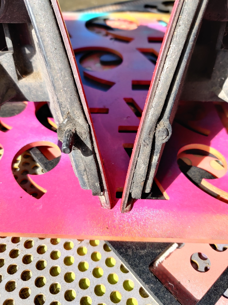

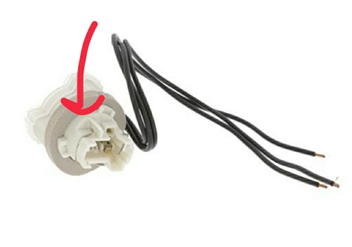

Ended up finding some locally for 45$ got the wire harness too. Only think wrong is the little post on the pointed part is missing and of course I didn't see that too I got home. I'm painting them right now does anyone know if that will be a problem? Anyone know where to get the gaskets that go around the sockets?

Parts stores have those gaskets some times.

As an alternative, a craft store may have foam sheets from which you can make your own gaskets. I think a piece of 3/4" copper, sharpened on the end, may punch a hole the right size for the center, and you could cut around the outside with scissors. Depending on your cutting skills, they might not be pretty but the'd be functional. As for the posts. IIRC, I believe those are just locator pins.
Lol I actually have some of those I will give them a try, thanks
