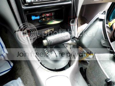

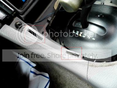

Step 1; Trim Piece Thingy
Your first step will be removing the trim from around your shifty-thingy. I put mine into neutral first, because I think I read somewhere you should. Don't forget your emergency brake! So with my shifter in neutral, I began grabbing around the edges of that POS and pulling.
Don't be too forceful, but don't be a pussy about it either. It'll come off eventually. It turns out the plastic tabs holding it in weren't where I thought they were at all! Maybe you'll have an easier time with this, knowing where they are.

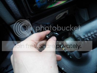

Step 2; Trim Piece Wire Thingy
So now you have that damn trim piece up, but it's plugged into something. What the hell, right? Well, don't worry about it this part is easy. Just pull the little black thing from the back of your plug thing and it'll slide right off.
No tabs to worry about or shit like that. Just give it a tug. Great! See how easy that was? So now your trim piece thingy is gone.

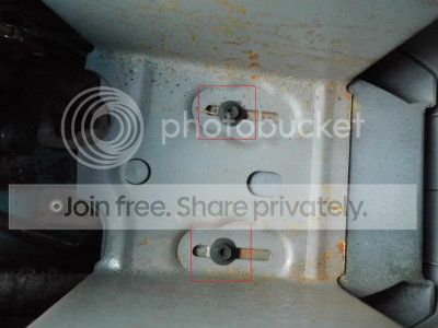

Now we need to finish getting that damned center console out of the way, because we don't have little bitty midget hands, do we? That's right, we don't. So, you need to open up your center console, and you'll find three square rubber thingies. We're going to take out only the two in front. I took out all three, because I didn't know only two have screws under them. This is where you'll need the Phillips head screwdriver that I didn't mention up in the 'things you need' list. Sorry about that. Anyway, use it on those two screws. Here's a picture for you visual learners;
Once you've got those two screws out, you've got to wrestle the basket out of your center console. This was a pain, and I kept thinking I must have missed a screw. If you're also thinking this at this point, you're wrong. Just keep trying at it, maybe ask your little sister to help. Once you've gotten the basket out, you can go on to the next pseudo-step!

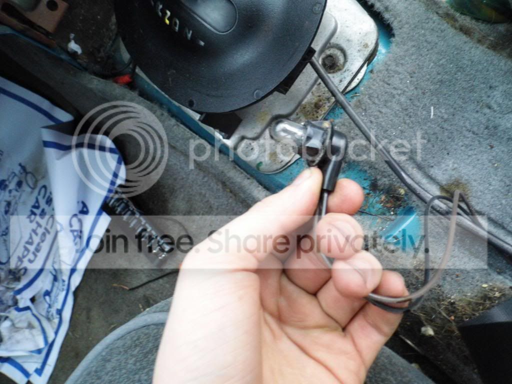

Look under the shift-thingy, and you'll see a place where some wires, in a plastic thingy, go into the shift thingy. That's your bulb holder thingy.
Grab it, and turn it to remove. Nice. So now, just pull the bulb from the socket, and replace with your super-bright white LED bulb. At this point, I went ahead and turned on my lights, to make sure it lit up.
Pretty! So yeah, now you just need to put everything back together. My advice is to make sure your seatbelt doesn't get screwed up under the center console. I found out this morning that mine was. So that's wonderful. If you haven't installed your LEDs into your HVAC yet, now is a great time, since you have to remove the trim piece from step 1, and the two screws from Step 3 to do this anyway. Here's a link for you lazy people; SN95 Gauge and HVAC LED Swap

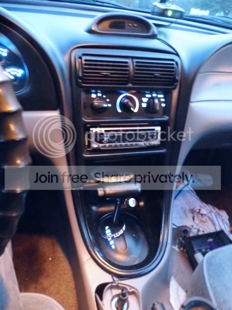

Finished Product;
Yay!
