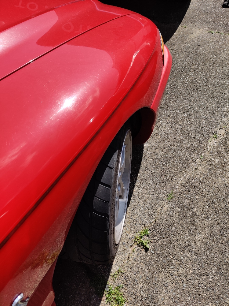

I seem to only notice this when on the highway going 60 or faster, does anyone else have this problem it can be a little scary cause you never know when it can happen. I've read it could be the crown of the road? Maybe my tires are too wide up front? I see in my stack of receipts I got with the car that they have taken it into get it aligned quite a bit. I've checked the ball joints they don't seem to be too bad, one has a little tear in it so I'll have to change it in the near future but that wouldn't do it would it? The front tires are 255/40zr17 94y ecsta mx kumho, rears 275/40zr17 98y with what looks to be 2inch spacers and the wheels are the 98 cobra R I believe.

what size spacers are those?
Wait till you lower it and learn about bump-steer.
Seem to me they were maybe bring able to turn too far, looks like a little rubbing is happening on the inside of the wheel.
