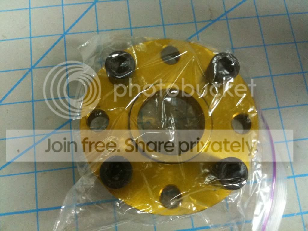

Think you may need this from Steeda which I have for sale.
