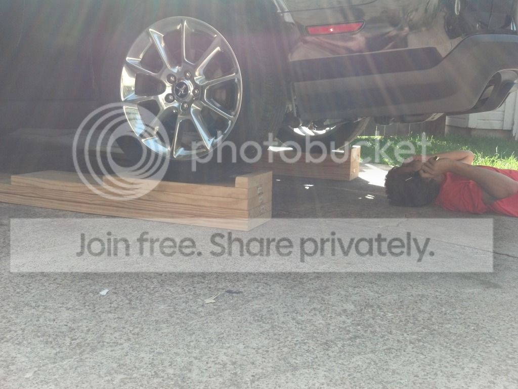

ScottyDsntKnow
Mar 22, 2008
1,488
29
these are the ones i made
You know... I might just do this and pull it out from underneath... I'm back on track with this, I just needed to figure out EXACTLY what I need. Also did more research on the COP swap and found out that one should either move the coilpacks or swap to a 99-up computer/harness as the adapter harness is basically a hack that works well for what it is but will start to have issues at a higher HP number. Even the guy who makes them says he won't guarantee anything after 500whp. I want to do the COPs for sure so I'm swapping to the 99-up stuff regardless if I stayed 5 spd or not.
I do not want to mess with jackstands still, I would like the car sitting on loaded suspension. If I build something like that that steps up aggressively as my lowered suspension allows, I can probably get that 18-22" of clearance I need to pull the trans out from underneath without dicking with pulling the motor. From what I'm looking at, swapping the harness looks like its not TOO bad with the motor in...
Cpotts13
Mar 11, 2012
1,594
36
Biloxi, MS
Just google how to make those ramps, i think I found them on a corvette forum. they work wonders with lowered cars.
