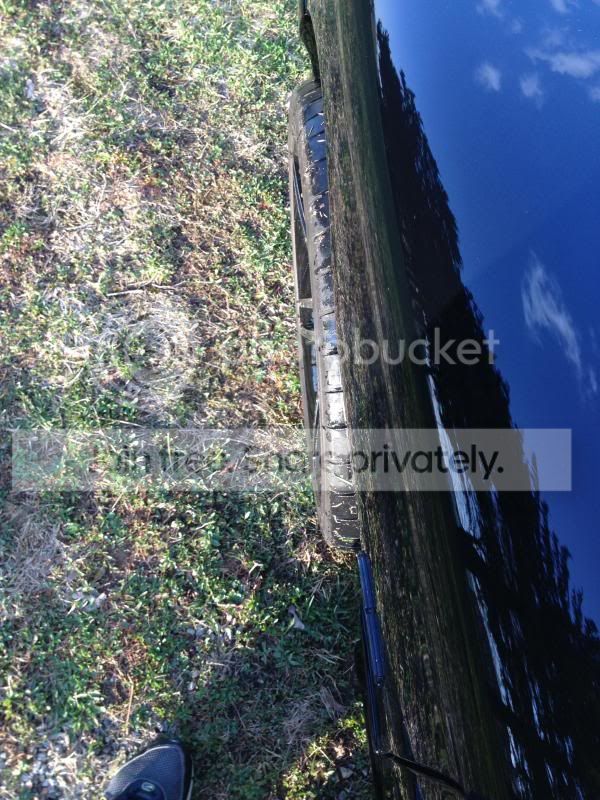

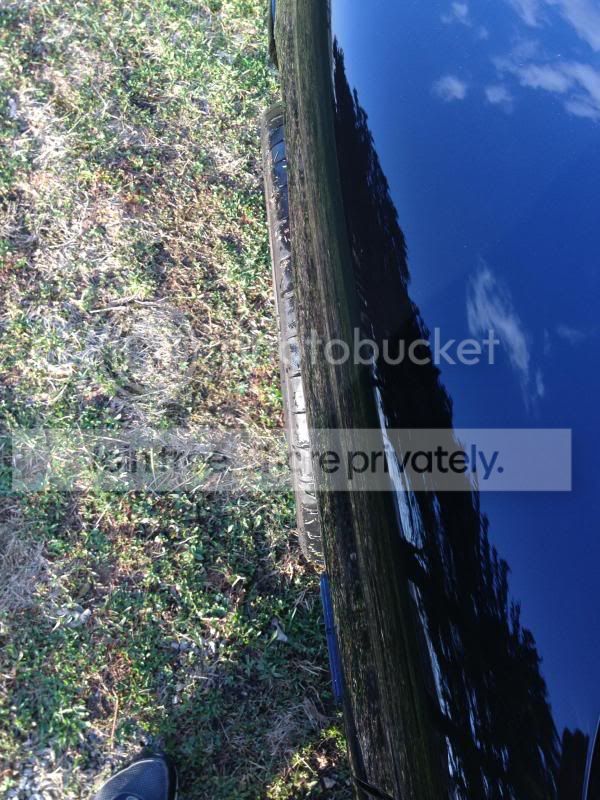

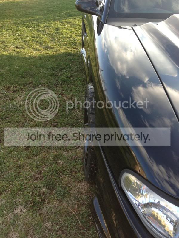

Damn, that doesn't seem right. The only reason mine slightly stick out up front is because of the weird tires I have on them combined with the wheel spacers (I think the spacer is only 1/8" though). If you want I'll take the front off and measure the physical distance of the wheel and see if it's different.

thanks but nah i'm good. it's the brake kit i have on there that spaced them out. just didn't realize it was that much until i got the wheels on there.
