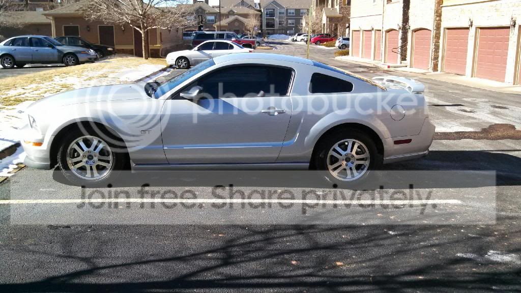

Gonna run TT this year, plus do some NASA instructing.
Got a 05 GT to DD and serve as a light track car. When I bought it ...
Haven't done too much ... yet. But not planning to.
Staying in TTD class really limits my modifications. Basically a stock 05 GT classes TTD and only has 5 points before TTC. So, my CAI is +1, some non OE swaybars is +2 (these are from a Brembo GT, $50 on craigs :D) and +1 for running 255mm tires instead of the D class 245mm. Not sure what else to do with 1 point, but here's how she looks with the new wheels. I picked up some Brembo GT wheels with 255 Pirellis for $600. Not a bad deal, drove them today for the first time. Definitely some sticky rubber.
Definitely a little deflated when I weighed it. 3700# with me in it!! I gotta shed some weight somewhere.

Very nice. My two cents would be some way to adjust camber or free up the exhaust. Not sure how the point system goes, haven't started nasa yet myself. When we ran or GT500, pushing was our biggest issue.

Yea, the stupid stock shocks/springs are a little squishy. But I can't take the 8 points to swap them out.
Hence the swaybars, the front Brembo bar is a little thicker than a stock 05 GT. But my rear bar looks like a toothpick compared to the Brembo rear. That should definitely help front grip.
I still need a shifter, the OEM one is horrible. Possibly some rear LCAs too. But that will probably wait for a few weeks.
