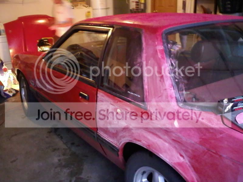

my friend is getting his car painted friday were doing all the prep work in my garage under the condtion he cleans everything :evil5:
we only worked on it a few hours, windshield is stripped along with door moldings and its blocked with 220 so far.
here are a few pics along the way...
oh yeah its a 90lx 5.0

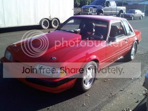

heres a teaser pic the car rolled out of paint this morning

wow 220 you need to use at least 800 before you spray that buggy in primer!!!!

220 was to remove what was left of the peeling clear coat. its not even close to ready, we pretty much just removed most of everything from the body that isnt getting painted.

not to step on duff's feet but you want to finish sand with 400-600 grit 800 grit is almost to soft for primer to stick. then you should wet sand your primer with a 600 grit paper then go over it again with 800 grit before you paint... good luck bro

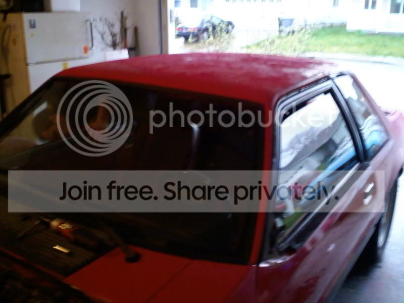

all the body work is done. loaded into the inclosed trailer at 330am it will be painted tomorrow morning.
also my garage is totaly red now.

its done looks alright from the picture i need to see it in person and snap a few more pics.

thanks, we did all the prep upto 600 grit in 3 days. the body/paint shop did final sanding (kept cost down and kept warrenty) the one thing the shop messed up was the bumpers. they forgot to spray the trim in black but they are more then happy to fix it at no cost.

i highly recomend never ever doing anything like this in a 2 car garage... soooooo messy. my friend had to scrub the floor with a wire brush and paint thinner, along with everything stored in there. to much cleanup............
on a positive note, more pics will be up tomorrow when the window trim is reinstalled.
