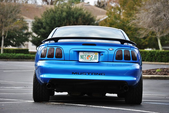

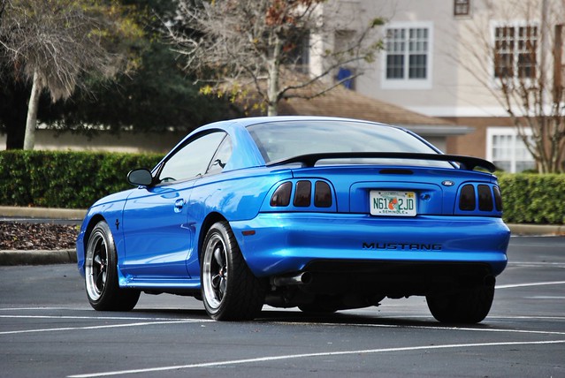

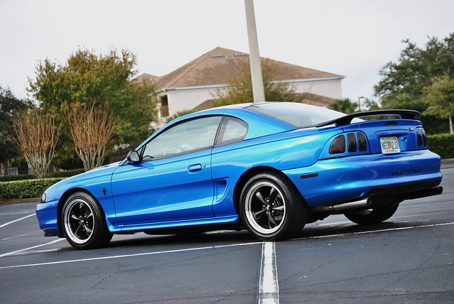

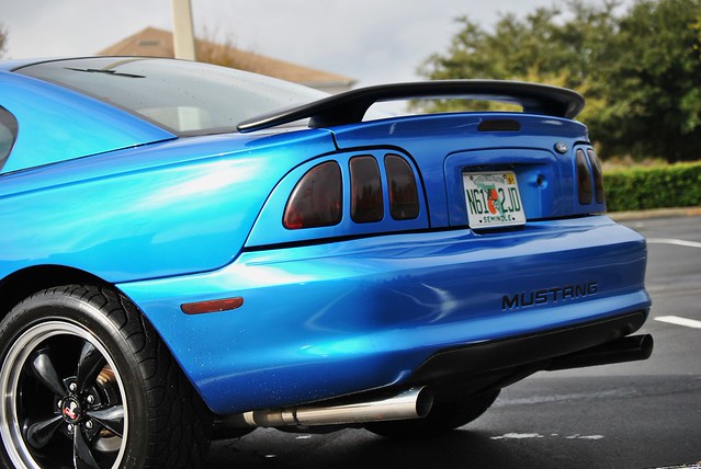

Well I wet-sanded and buffed them today, along with the side markers (which I think could use another coat maybe) but all in all I'm very happy with the end result... Here are some pics...

very nice. What process did you use to wetsand and buff?
I want to know,
1. Did you clear before sanding?
2. What grits did you use?
3. What product(s) did you use to buff? And by hand or machine?

Yeah I cleared before sanding, I used 2 coats of clear...
For the actual sanding I went out and picked up a 3m headlight resto kit, I kinda changed their process though
1. I used the 800 grit pad from the kit ( wet-sanded)
2. I wet-sanded by hand with 1500 and then 2000
3. Then used the grey pad as instructed from the kit
4. And finally hit them with the provided orange pad and rubbing compound
