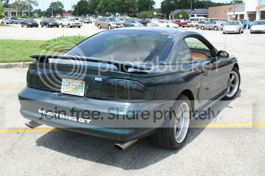

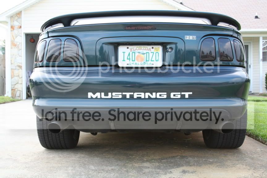

Get Money- it looks like you have this set up already? do you have anymore pictures besides the sig?
gt96stang
May 11, 2006
4,520
These were with crappy sumitumos.. and pre exhaust dump

EastBayStang98 said:
get money, you car is sick bro
Thanks man.... Although it's nothing more than some wide rims/tires... and a small drop.
