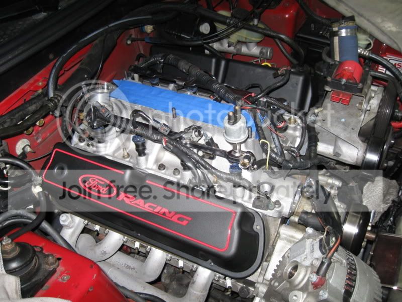

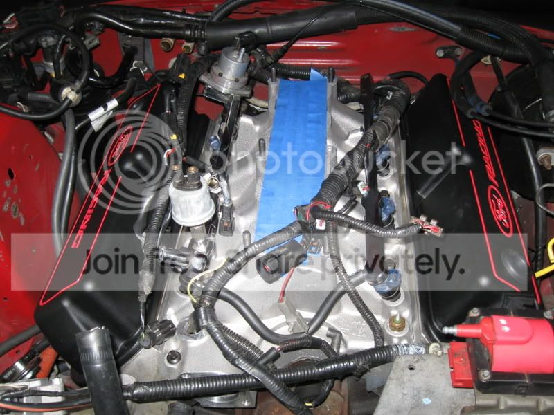

Even though it was Ford racing valve covers, I had the same problem. Luckiley I have a 88 fox engine in the garage, I used the valve cover bolts from that engine. If I had a choice I would buy a set of studs. But if I was in a bind like you, fox ones would work if that would make them easier to find.

Used the stock bolts on my Ford racing valve covers and it seemed to work fine.
same here, but when I switched over to the fox covers, I had to use longer bolts
