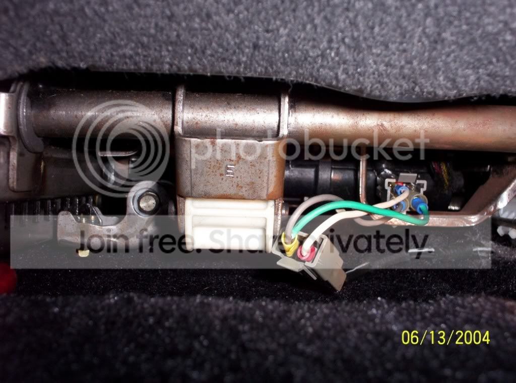

I put '04 seats in my '98 and had to cut the piece off of the seat tracks that holds the seat belt buckle for the newer style, and I put bullet connectors on the wires. The '04s are a lot more comfortable. Fred
