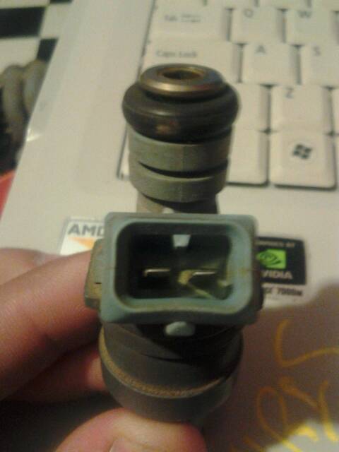

Here is the injector I have grin the mark viii

The jetronic plugs usually found on the old style fat injectors(ev1). Uscar is found on the new style injectors the slim ones (ev6)... Now you can get the ev6 injector style with old ev1 connection(jetronic). Which I recommend you do instead of using the adapters.. Much better injector over all..
