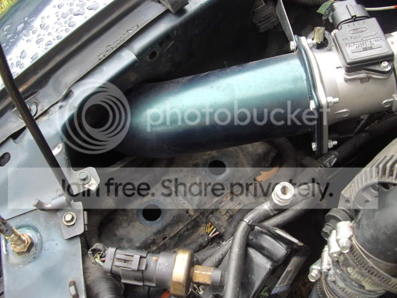

CW Cobra said:
toyman can u post more pics.. vvhat did u make to get it to sit on?
It's mounted on a bracket that's bolted to the inner fender. This picture shows a bit more detail.
